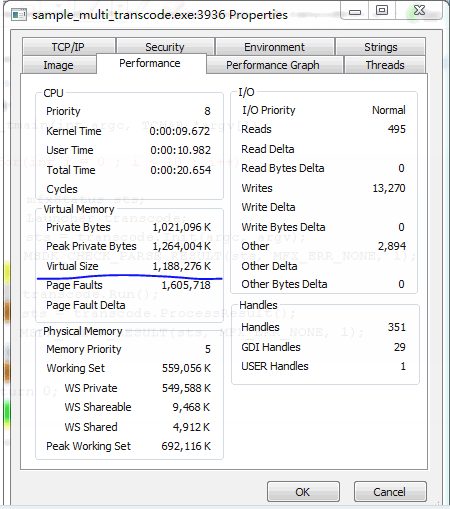

I'm using Media SDK(Media SDK 2013) for the H.264 transcode .
I modify the sample_multi_transcode.cpp like this (11.png) ,
int _tmain(int argc,TCHAR *argv[])
for(int i = 0 ; i < 10 ; i ++)
mfxStatus sts;
Launcher transcode;
sts = transcode.Init(argc,argv);
MSDK_CHECK_PARSE_RESULT(sts,MFX_ERR_NONE,1);
transcode.Run();
sts = transcode.ProcessResult();
MSDK_CHECK_RESULT(sts,MFX_ERR_NONE,1);
return 0; ---------------  break point ;
when I is use the cmd line "sample_multi_transcode.exe -sw -i::h264 1080P306M.h264 -o::h264 output2.h264 -w 320 -h 288 ", the
sample_multi_transcode.exe virtual memory is ok ,about 150M.
but use the cmd line         "sample_multi_transcode.exe -hw -i::h264 1080P306M.h264 -o::h264 output2.h264 -w 320 -h 288" ,the
sample_multi_transcode.exe virtual memory is 1.2G(12.png) !

The title of the forum post indicates that you are observing a memory leak, but the following details you provide does not mention leak but instead total consumed memory when running your workload.   Can you expand on what you mean by memory leak?
Regarding total memory usage. HW accelerated codecs are expected to consume more memory than SW codecs, especially if using system memory to store surfaces.
However, I would not recommend using "virtual memory" as your metric since it is misleading. Instead please, use metric such as "private bytes" or similar. It will give you a more accurate representation of the true size of the allocated memory.

 leak 70M memory everytime when using the "-hw" cmd line ,and I use the "for(...)" keyword , making the private bytes grow up to 1.0G .
 then I debug the Pipeline_transcode.cpp , m_pmfxDEC->Close() and m_pmfxENC->Close() not free the memory which the Init(...) malloc.

I can confirm the memory leak. It turns out that the decoder resources are not freed at session destruction, as would be expected.
We are working on finding the root cause for the issue and will keep you updated as soon as we have more info to share.
Thanks for helping us make the Intel Media SDK better.
BTW. In the meantime, there is an alternate Media SDK opaque transcode sample as part of the Media SDK tutorial (http://software.intel.com/en-us/articles/intel-media-sdk-tutorial). This sample does not showcase the memory leak you have observed.

My project transcode 1080P h264 video to cif h264 video ,so I must use the vppresize
 however this issue still exist in "simple_5_transcode_opaque - async - vppresize" sample .
The issue is blocking my product release, I need your help,Could you fix it ASAP?
 Thanks a lot.
Petter_L_Intel
488 Views
Hi Cheng,
sorry to hear that this issue is blocking product release. We are working on resolving the issue as soon as possible.
I can confirm that the issue occurs using the tutorial sample you refer to. Thanks for making us aware of this.
Just a heads up. The issue may turn out to be related to 15.28 graphics driver branch (required for your 2nd generation Core Processor) which is rarely updated, so if this is the case a fix may involve quite long wait. We'll determine if this is the case shortly.
The issue is connected to the "opaque" memory use case. A workaround is to explicitly use D3D memory surfaces instead. Not sure if this is feasible for your application, but I strongly suggest you explore this path as a backup.
