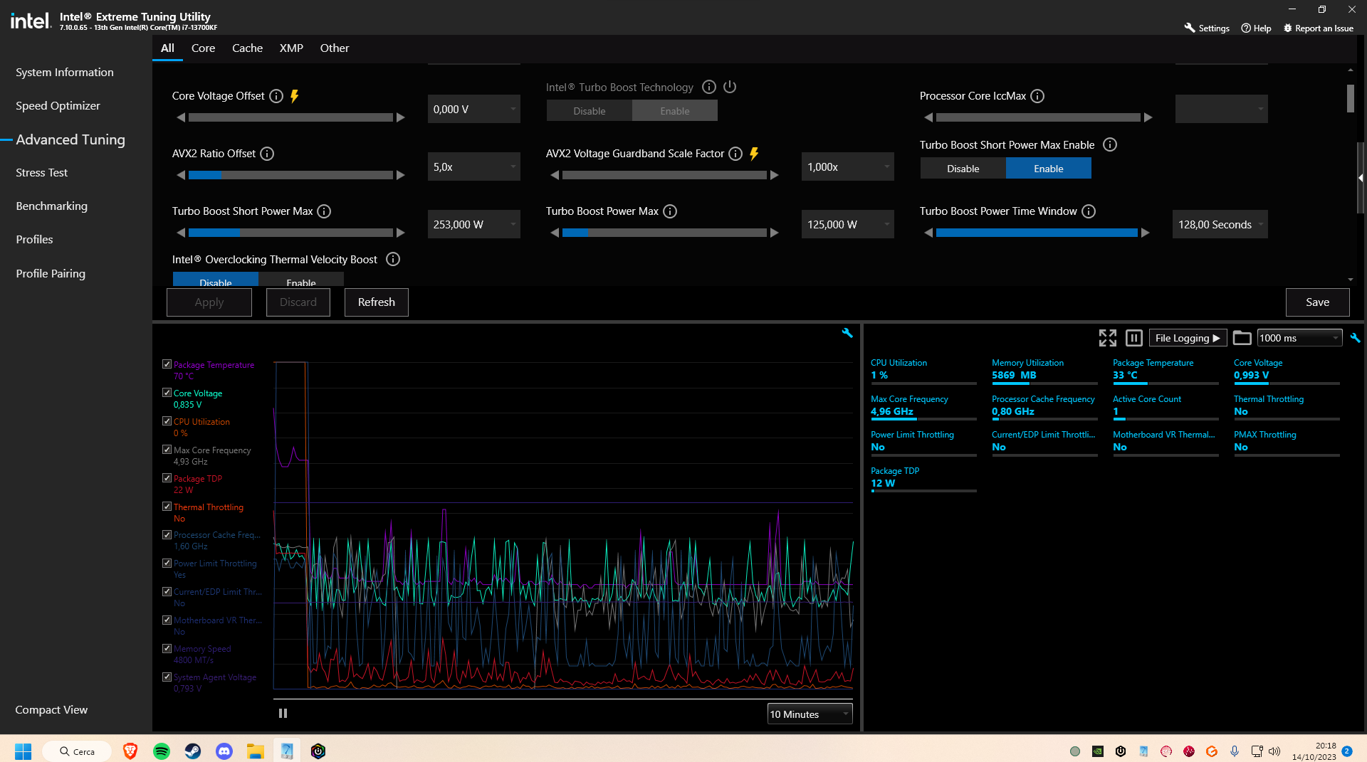

Hello, my CPU is I7 13700kf and when idling , the cpu core voltage is having this behaviour and i want to know if it is safe or there is something going on. I noticed these spikes and dropping in cpu core voltage in XTU , but when under load the voltage is stable and constant. See attached screenshot.

Here's the new files with updated bios. In the attached the screenshot, I've noticed that the CPU keeps spiking and dropping voltages and frequency in idle even with updated bios. Hope it helps to troubleshoot , if it is a problem in the first place.

Based on the information collected so far, your Intel® Core™ i7-13700KF Processor is working as expected. There is no specific value for the processor to operate, it will fluctuate based on the workload.
Also, by checking the reports, your CPU passed, and the system is now up to date. Could you confirm if you are experiencing any kind of BSOD, crash or unexpected shutdown?
