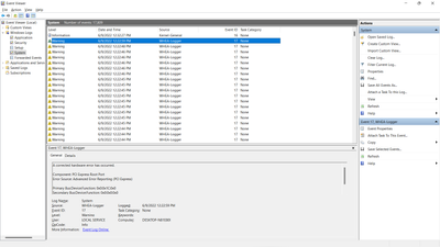

My Dell Inspiron 17 5000 series laptop is freezing frequently. When this happens there is no response to keyboard or mouse. My only solution is to hold down the power key until the machine turns off and then to reboot.
Frequently I check the windows logs in event manager to see why this might be happening.
The only thing that occurs every time is a slew of event entries:
A corrected hardware error has occurred.
Component: PCI Express Root Port
Error Source: Advanced Error Reporting (PCI Express)
Primary Bus:Device:Function: 0x0:0x1C:0x0
Secondary Bus:Device:Function: 0x0:0x0:0x0
Primary Device Name:PCI\VEN_8086&DEV_9D10&SUBSYS_08111028&REV_F1
Secondary Device Name:
In device manager under System Devices I see:
Mobile Intel(R) Processor Family I/O PCI Express Root Port #1 - 9D10.
I use Dell Support Assistance to always keep myself current with fixes they provide.
I have been running Windows 11 for many months, but this also happened when running Windows 10.
Any suggestions on how to fix this problem would be appreciated.

After the reboot I check the Windows events and consistently see events:

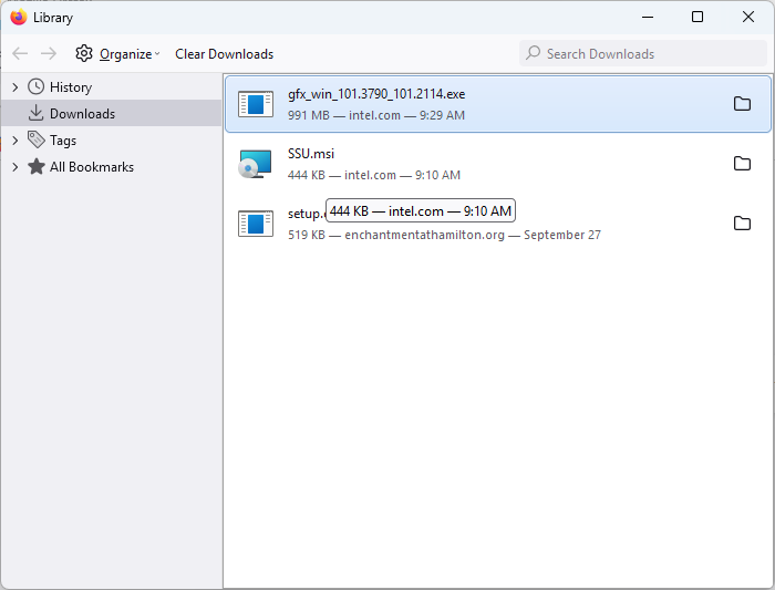

mmaleson
5,242 Views
So here I am, 2 years later and having the same issues.
I installed the first 2 objects in the above screen (both from Intel) and rebooted.
You can see in the first hour alone there were 12,455 event log entries written - all for the same device: Mobile Intel(R) Processor Family I/O PCI Express Root Port #1 - 9D10
My question has really never been answered. Can I disable this device safely.
I don't know what happened to make this resurface,  but it's  pain in the neck.
Thanks very much,
