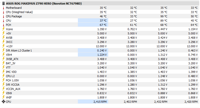

Hello guys.
I am completely new to hardware. Four months ago, I bought a new computer that is primarily used for 3D/Rendering/Programming and occasionally gaming.
The machine is as follows:
  • Intel i9 14900K
  • ROG Maximus Z790 Hero
  • Corsair AX1600i
  • Corsair iCue H170i Elite
  • 2x 32Gb DDR5 Corsair CL32 6400Mhz
  • Asus RTX 4090 ROG STRIX

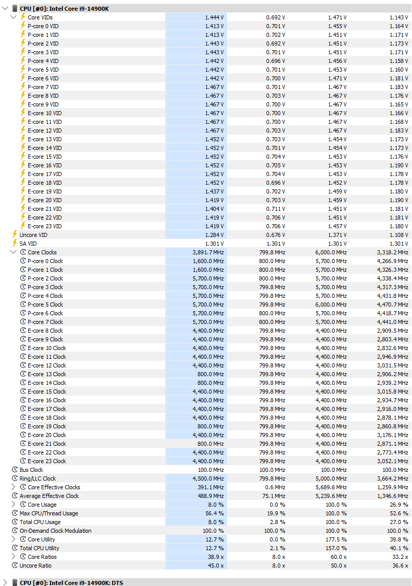

The BIOS installed by default is version 2202, which (I believe) already includes Intel's profiles. I have never had a single issue with the computer until yesterday when I experienced a complete system freeze (for some unknown reason).
Below, I’ve attached some photos of the results from HWInfo after running a test with Cinebench 2024. I also ran a test with the Intel Processor Diagnostic Tool without any errors.
Is it possible, with this data, to determine if my system is stable or if I might encounter problems with this configuration in the future?
Thank you.

If you have the latest BIOS you should be fine, no more degradation.
But the hardware has been in use for four months, so the chip may have degraded already despite the progressive measures Intel put to limit damage.
The temperatures and voltages look fine for a 14900K, the 14900K is notoriously difficult to cool.
If you get another unexplainable crash or bsod you may want to RMA anyway, since the CPU is in a gray zone where it may or may not have degraded enough to cause crashes/freezes.
As a general rule, if your chip saw extended, unthrottled AVX loads on few enough cores that it didn't throttle either from temperatures or power limits it has probably degraded.

Is there any safe way to test the chip? I already tested with IPDT and Cinebench. No errors, everything ok, but the CPU reaches 100º, 350W+, 1.445v.
I'm very, very confused about this topic. Don't know what to do to be honest. Right now the system is stable but I'm not sure if it's beeing damaged with these values..
dsan
3,778 Views
UPDATE:
I flashed the bios with the new update (0x129 microcode) and applied all the intel default settings, performance template.
All my temps, vcores, watts are now ok. No errors, no throttling and same performance!
