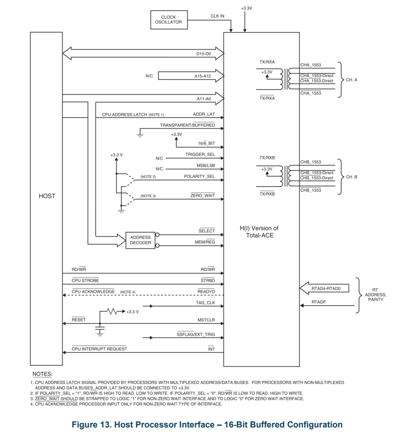

   I am Veerappan P A.  In our project we use mil-std-1553 supported IC BU-64843-102, It is parallel interface, it have 16 bit data bus, 16 bit address bus and control signal. we need processor to interface this IC. The interface diagram is given below.
