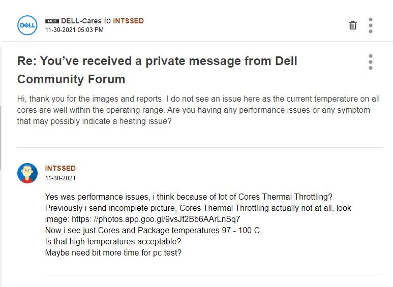

Ofcourse i can increase Fan influence to prevent Thermal Throttling? Not sure is it best solution?
There some screens from first conversations:

Hello IntsSed
Thank you for the information provided, for fan configurations our recommendation is to check with the OEM since they are the ones that integrated the cooling system and know how to configure it for better performance.
Now, you can use our Intel® Processor Diagnostic Tool to check the current status of the processor, this tool will run a series of tests on your processor and determine if it is working as expected or if there are any issues with it, please download it from the following link, run it and attach a screenshot of the results to your response:
https://www.intel.com/content/www/us/en/download/15951/intel-processor-diagnostic-tool.html
Also, please let me know if the higher temperatures are present when running high-demanding tasks or if they are when the system is idle or on low-demanding tasks.
