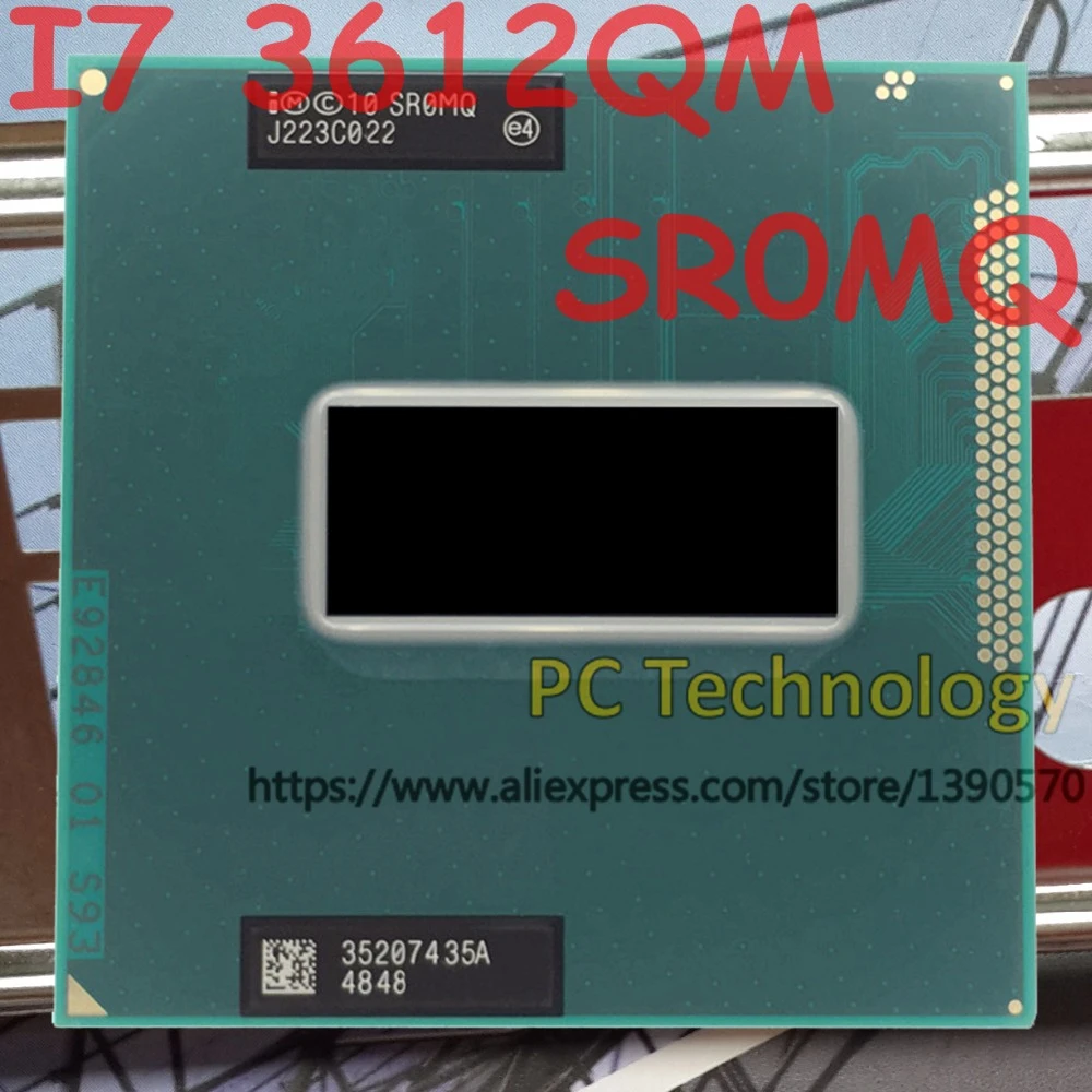

Is it possible to identify an i7-3612QM using the number printed on the CPU?
https://ae01.alicdn.com/kf/HTB1IfzbeMb.PuJjSZFpq6zuFpXaD/Original-intel-core-I7-3612QM-sr0mq-processador-cpu-i7-3612qm-2-1-ghz-3-1-ghz.jpg_Q90.jpg_.webp
AlHill
4,381 Views
Yes, SR9MQ (the spec code) is found under "ordering and compliance, retired and discontinued" on this link:
https://ark.intel.com/content/www/us/en/ark/products/67356/intel-core-i7-3612qm-processor-6m-cache-up-to-3-10-ghz-rpga.html
This is a socketed processor and is NOT soldered to your motherboard.
