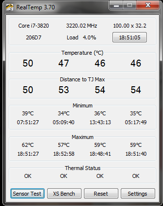

My temps are fine ? I know for this cpu the TCASE is 66.8°C. In most benchmarks i did under full load cores 2,3,4 wasn't more than 66c but the first core always is running hotter i saw 72cmax.
Idle temps i get 38-45 again only the first core running 41 and above the rest are staying 37-39 max
Thanks for any advice.

It seems to be normal. Even on idle mode, the Operating System runs different processes within its back ground and will always need the processor resources.
Furthermore, differences between the core temperatures can be from 15 to 20 °C.

I hope u are right , i still don't like my temperatures thought . I don't want my cpu hit 90c in the summer.
I saw similar overclocked cpus to hit my temps but they are overclocked to 4ghz.
I ll do a better research and i ll post again.

Hi again am still wonder if my temps are alright under 4.0% load while playing a game.
My video card hit 80c maybe is overheating the cpu ?
Any help welcome .
