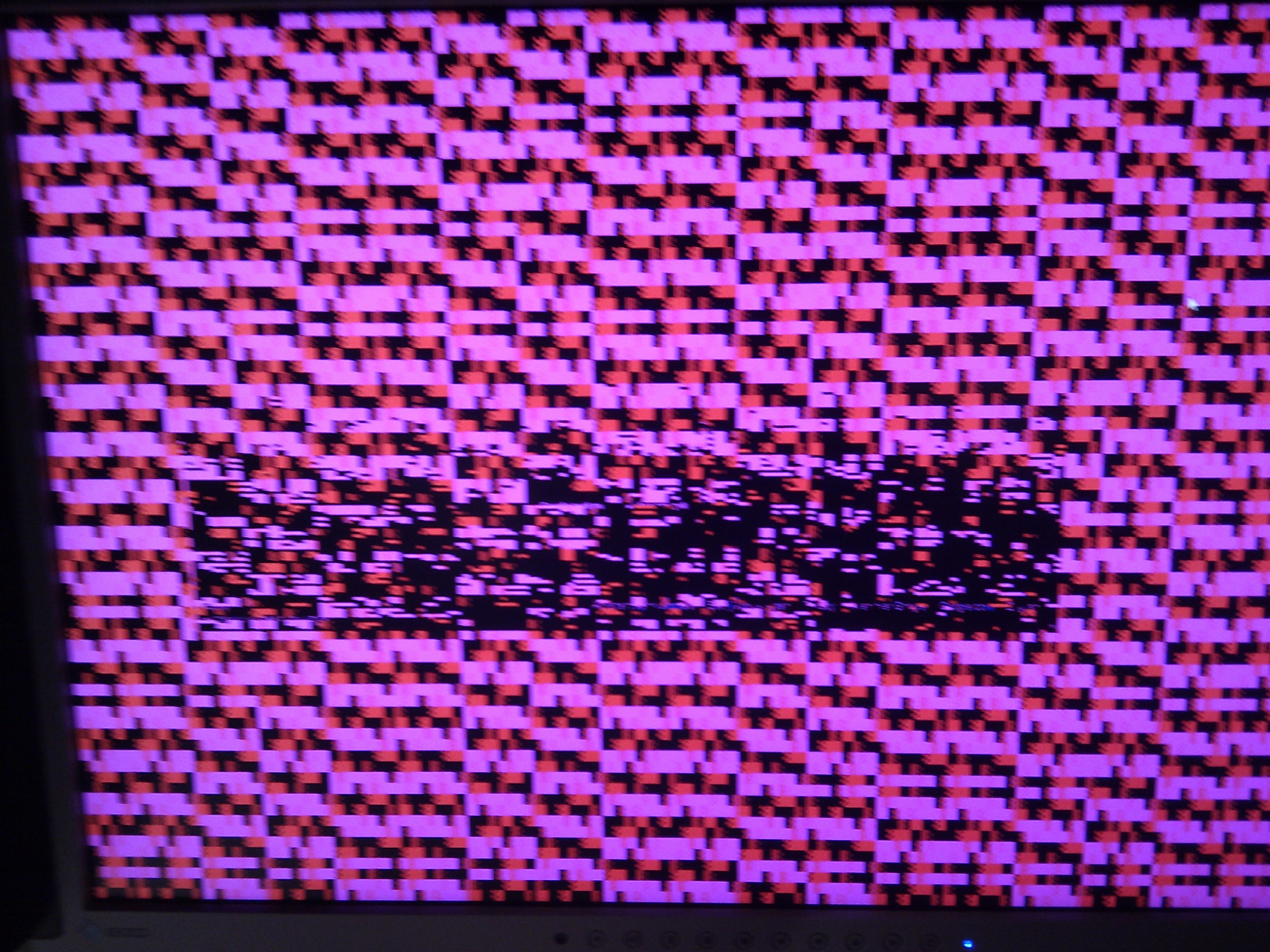

I have tried it on an Asus P9X79 PRO motherboard and it boots, but i got random purple screens in Windows 7 due to my MSI N580GTX Twin Frozr II OC videocard not seated well in the pci-e 16x slot (i think)...the SATA 3 port is blocking the card to be seated well.
Random purple screen:

I do not think the change in gold color on the processor contacts would cause any issue at all, but I would suggest testing this processor on a motherboard that is fully supported and that does not have the random purple screens.
