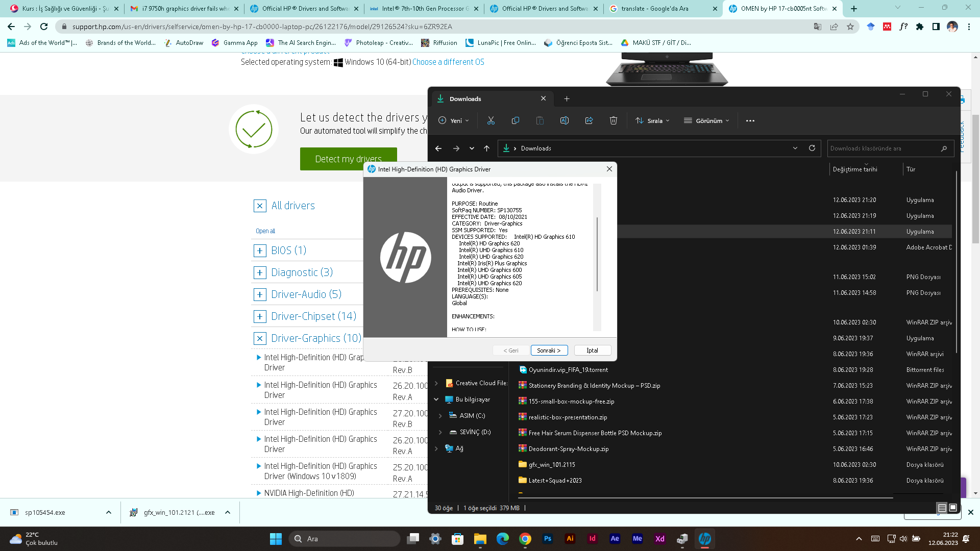

Hello, my computer supports the i7 9750h graphics driver, but I am getting an error while installing it.
It says supported here https://www.intel.com/content/www/en/en/products/sku/191045/intel-core-i79750h-processor-12m-cache-up-to-4-50-ghz/downloads .html
My computer is OMEN by HP 17-cb0005nt

The current intel uhd 630 could not be installed on the device. I tried the win 10 version from the hp site, but it didn't support it.
I tried the win11 version from the hp site again, but I noticed that it did not support the uhd630 on the installation screen. (but I tried again)
Before I formatted my computer, I was seeing both intel and nvidia drivers, but after formatting my intel driver disappeared. I couldn't reinstall.

Hello asimsevin, Thank you very much for providing that information and the SSU report.
Based on the information shown in the SSU document, the Intel® graphics controller is not being recognized, only NVIDIA GeForce RTX 2070 is being detected.

Hello asimsevin, I just received an update on this matter.
After reviewing the case we can confirm, based on SSU and the screenshot from the device manager, that, as mentioned before, only the dedicated GPU is being detected and that the error shown in the screenshot is Exit code 8. Here, you will be able to see further details about this error and troubleshooting steps to attempt in order to try to fix it:
https://www.intel.com/content/www/us/en/support/articles/000088393/graphics.html
So, it seems the computer does not have hybrid graphics enabled or it is not supported on this system. In order to confirm those details, what we recommend, as the next thing to do, will be to get in contact directly with HP support to gather the instructions on how to enable the integrated graphics in the BIOS of the laptop.

Hello again Alberto
I followed exactly the instructions you left and installed inal uhd 630 but it looked wrong (exclamation point). As you said, the device was related to the IGPU feature in the bios. It wasn't visible in my bios, I think my bios features are either insufficient or this feature is missing. I will contact HP for this
