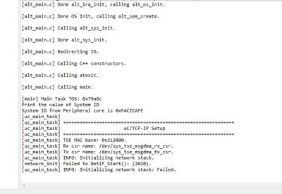

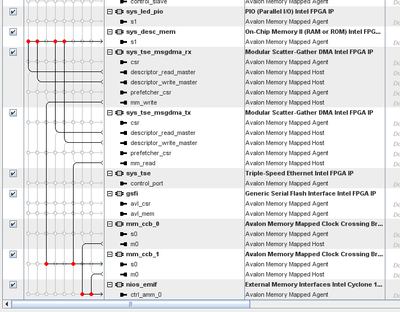

Hi support,
  I am learning the simple socket server design on Cyclone 10 GX.
For unknown reason, the initialization process stopped with the error code (2010),
It's the TSE with DP83848.
The signals on MDIO and MDC is working.
Therefore I would like to know how to debug this issue.
Thank you.
BRs,
Johnson

JLee25
4,689 Views
  It's a custom board with C10 GX and DP83848.
We use Nios II with NicheStack in the past and are porting the Niso V now.
So the Hareware should be fine.

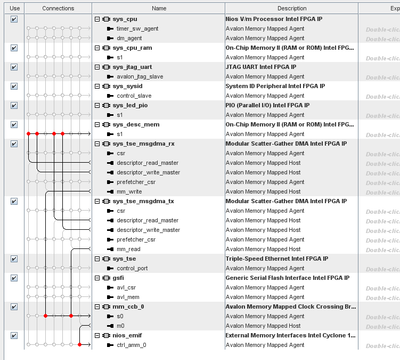

The qsys connection is like below.
The Nos V is running on EMIF.

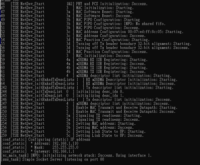

Following your instruction, the socket is running now.
But I can not connect to the server and ping to the specific is not responding..

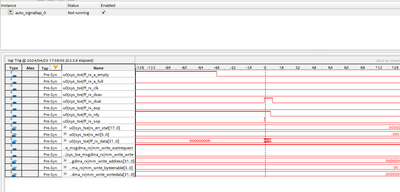

Form the STP, the ff_rx_a_full is always high.
I think there are problems on the FPGA side since the TSE IP is not responding..

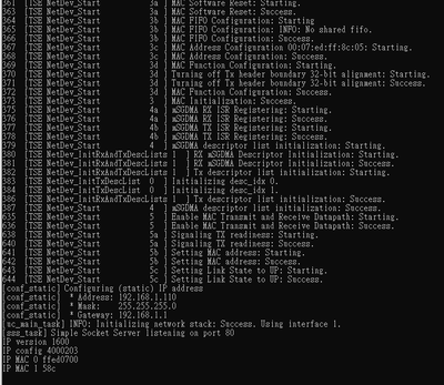

With the addresses now configure properly, and that the message “[sss_task] Simple Socket Server listening on port
<port number>” is displayed when the µC/TCP-IP Stack is ready for connection.

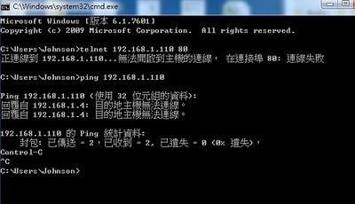

  I tried telnet and ping command.
But no reply from the server

And I am debugging the qsys..

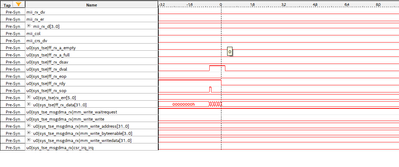

I can see the mii_rx_d to TSE.
But for unknown reason, the ff_rx_a_full going high and ff_rx_rdy goes low after the SSS starting.
JLee25
4,613 Views

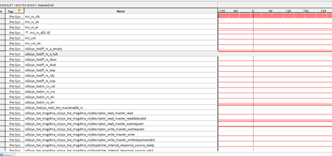

  I think the problem is the TSE not responding for unknown reason after the SSS running...
I STP the signals between TSE RX and the RX MSGDMA.
The ff_rx_rdy going low and not returned to high.
Perhaps something wrong on my Qsys setting or..
I feel the MSGDMA is not working and there's not much data about this IP..
I upload the QAR file for your analysis.

JLee25
4,124 Views
  From the STP content below, I think the ff_rx_rdy is a signal from DMA.
After downloading the sof and elf, the system booted with ff_rx_rdy high, which indicate to the core ready to receive data.
But it went low after with the network connected..
Therefore I guess there are problems on the msgdma ..
I read back some register settings on TSE core, and thought it should be configured correctly.
JLee25
4,078 Views

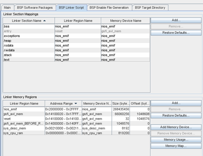

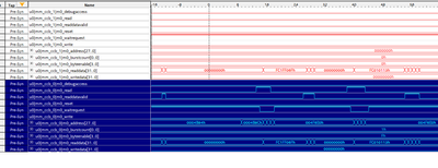

  I modify the design with Nios V to EMIF through a memory mapped clock crossing bridge and DMA through another bridge.
But for unknown reason the DMA bridge is not running...
I STP the bus and found only Nios V is running..
Any suggestions ? DMA driver or ...

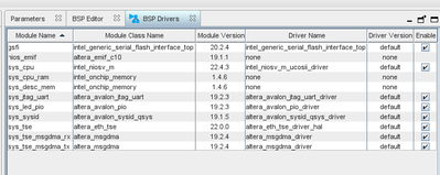

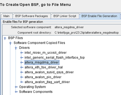

Is the DMA & EMIF visible in the "drivers" tab in BSP-editor?
JLee25
4,016 Views
  I believe so, as
and
