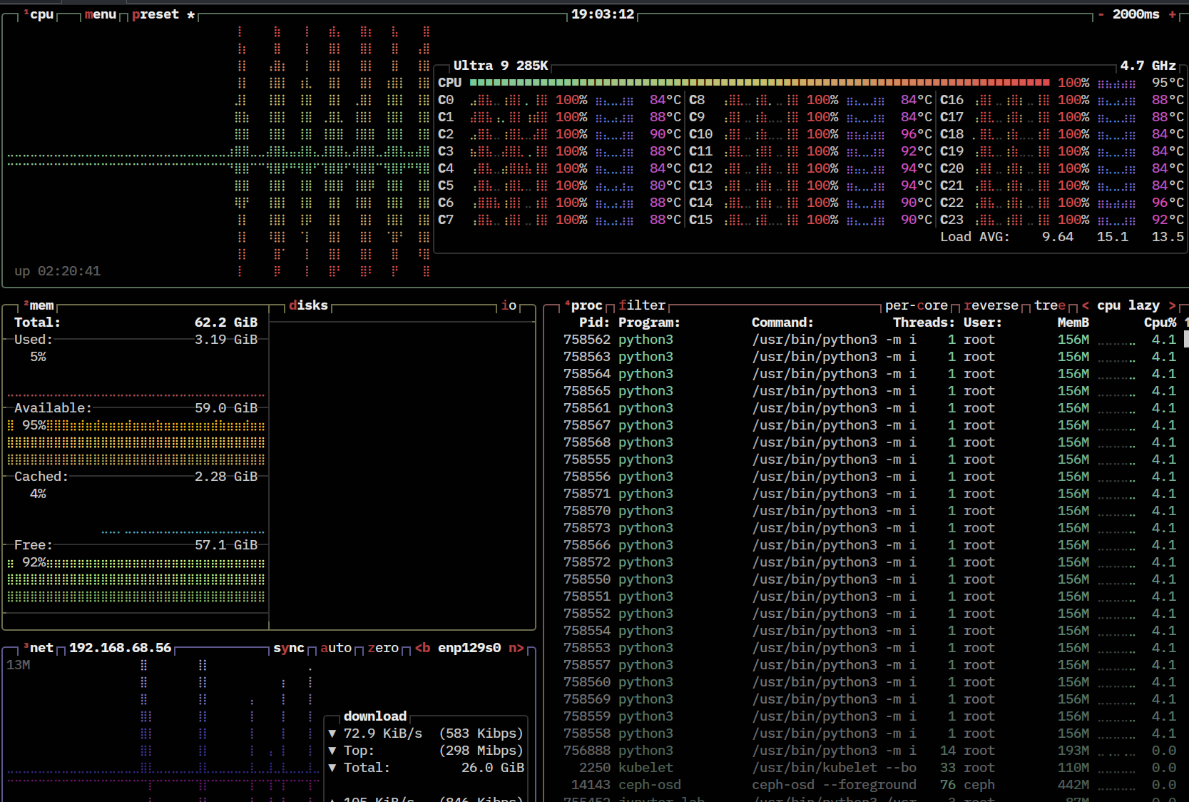

I have the 285k using an ASRock Intel Core Ultra Z890 LGA1851 RL-ILM Mini ITX Motherboard. I run Fedora CoreOS on this node of a Kubernetes cluster. I experience the same effect running on the node without using Kubernetes.
Fedora release 41 (Forty One)
NAME="Fedora Linux"
VERSION="41.20250105.3.0 (CoreOS)"
RELEASE_TYPE=stable
ID=fedora
VERSION_ID=41
VERSION_CODENAME=""
PLATFORM_ID="platform:f41"
PRETTY_NAME="Fedora CoreOS 41.20250105.3.0"
ROM version Z890I-Nova-WiFi_2.23.AS03 dated 12/26/24
I have some intensive python based workload that spawns multiple threads up to the maximum number of cores available. It's doing some intensive Simulated Annealing workload that looks for the optimal tuning for microtonal musical chords to low number ratios. I have to run the algorithm multiple times for every chord in a Bach chorale, searching for the optimum tuning. It takes about 45 seconds per chorale to come up with the optimum tuning for every chord. By the time it finished one chorale, it moves to the next.
Unfortunately, once it has run at 5.7 gHz for two minuntes, it suddenly deprives my python program of any CPU resources at all. I run btop on linux, and it shows the temperature rising to around 80c, power to 250 Watts for the first 120 seconds, then drops to 40 watts, and 46c, but 0% CPU is allocated to my python program. I can leave the program running for half an hour, and it makes no progress. I have to delete the kubernetes pod and restart it in order to regain any performance. It repeats the same high CPU 5.7 gHz for 120 seconds, then down to zero cpu.
If I switch the turbo off, it runs fine at 3.7 gHz.
      echo 1 | sudo tee /sys/devices/system/cpu/intel_pstate/no_turbo
But I'd like to get the extra speed. I read in the intel Turbo P-states Support guide for kernel parameters, and it says "More precisely, there is no guarantee that any CPUs will be able to stay in any of those states indefinitely, because the power distribution within the processor package may change over time or the thermal envelope it was designed for might be exceeded if a turbo P-state was used for too long."
So is this working as designed and I am limited to 3.7 gHz for long running processor intensive workloads?
I posted two images, one with all 24 cores running at 100% for about 60 seconds, then at two minutes into the run, it drops to 0%. It never gives any resource to my python application after that. I could live with reducing it to 3.7 gHz, but zero is hard to live with.

Does disabling thermald.service make any difference?
prent_rodgers
4,231 Views
There is no thermald service running.
prent_rodgers
4,198 Views
I should also mention that I can run synthetic stress workloads for a long time with no slowdown. To stress the CPU, here is another method. It never throttles this, allowing 5.7 gHz and 270 Watts for ten minutes, reaching 100c. When I cap at non-turbo, it only uses 134 Watts and the temperatures are in the 50's.
taskset -c 0-24 stress-ng --cpu 24 --cpu-method stats
I can also run a kubernetes based stress app for a similar amount of time vish/stress as a container image with
args:
- -cpus
- "24"
prent_rodgers
4,198 Views
Perhaps it has something to do with a combination of CPu and memory accesses driving too much power at the motherboard level.

prent_rodgers
3,608 Views
It looks like my power supply has gone casters up. After about three weeks, it could not power the CPU to POST. The fans ran, but nothing else. Now it won't power up at all. I've asked for a replacement from the manufacturer. This could be the root cause of the problem but it will take a few weeks to determine while I wait for the replacement.

I took the advice to improve my cooling, but made the fatal mistake of removing the CPU to try to clean the exess thermal paste, and ended up getting paste all over the pins. In trying to clean them I bent several. Now it won't boot. I've ordered a replacement board and hope to try again in a week. I'm assuming that cooling was at fault for now.

prent_rodgers
2,710 Views
I finally was able to get the PC working again after the power supply failure, and a few other problems. The 285k is exceptionally fast, but only for about 2-3 minutes. Then is slows down to 800 hHz, and my python program is completely starved of CPU resources. This doesn't happen when I run stress-ng.
For example, this runs fine for five minutes, consuming around 330 watts, temperatur peaking at 105c, running at 5.4 gHz across all 24 processors:
taskset -c 0-24 stress-ng --cpu 20 --iomix 4 --vm 12 --vm-bytes 1024M --fork 4 --timeout 300s
All good. But there is something about my python workload, that just flat out stops after three minutes of hard work. I'm at a loss to understand what is happening.
I replaced the motherboard, power supply, and cooling system. But that improved the situation. Previously it throttled down to 400 mHz after only 60 seconds. I am able to get about 2:30 before it slows to 800 mHz. Attached are two charts that show everything humming along at 5.4 gHz, then during the ninth run of the complex Python Simulataed Annealing, it slows to 800 mHz. It was supposed to run through 11 different chorales, and I only got 8 completed. Bach wrote several hundred, so I have a ways to go yet.
Here is the current state of the machine:
System-manufacturer :  ASRock
System-product-name :  Z890I Nova WiFi
Bios-release-date :  12/25/2024
Bios-version :  2.23.AS03
Operating system:
     cat /etc/*release*
NAME="Fedora Linux"
VERSION="41.20250117.3.0 (CoreOS)"
RELEASE_TYPE=stable
Kubernetes version 1.30.9
Here is the running container:
k exec -it tonicnet-d-547d6497d4-44rk9 -- bash
  bash-5.2# cat /etc/*release*
Fedora release 40 (Forty)
NAME="Fedora Linux"
VERSION="40 (Forty)"
ID=fedora
VERSION_ID=40
I have made no changes using the ASRock bios menus. I'm willing to try modifying anything that won't damage the CPU.
