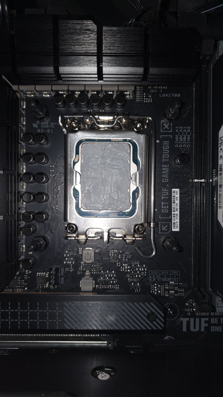

Today, I ran my first computer test and discovered that it immediately shows 100 degrees.

How the thermal paste was applied in the store where my PC was assembled - photo_2025-03-08_04-43-59
How I applied it myself (I bought Arctic MX-6 ULTIMATE Performance) - photo_2025-03-08_04-44-00

Default BIOS settings with the new thermal paste - photo_1_2025-03-10_03-02-53
Undervolting settings I applied with the new thermal paste - photo_2_2025-03-10_03-02-53
These are the overclocking settings:
- Vcore Voltage (Manual Mode) is set to 1.3V.
- P-Core Ratio is set to 53, giving a clock speed of 5.3 GHz.
- AI Overclocking is set to Level 3 (automatic overclocking level).
- AI CEP (AI Current Excursion Protection) is set to Auto, which may affect power consumption and overload protection.
>>> Power limits are set according to the table for my processor model - https://community.intel.com/t5/Processors/June-2024-Guidance-regarding-Intel-Core-13th-and-14th-Gen-K-KF/td-p/1607807
Please note the temperatures before and after and tell me what you think.

Hi FabulousJackfruit342,
Upon receiving the files, you provided. I think your system is running fine since it's completely normal for the system to experience elevated temperatures during such tests. For reference, you can check this link: Why Is There a Persistent Observation of High Temperatures When...
Do you only notice high temperatures during stress tests?
