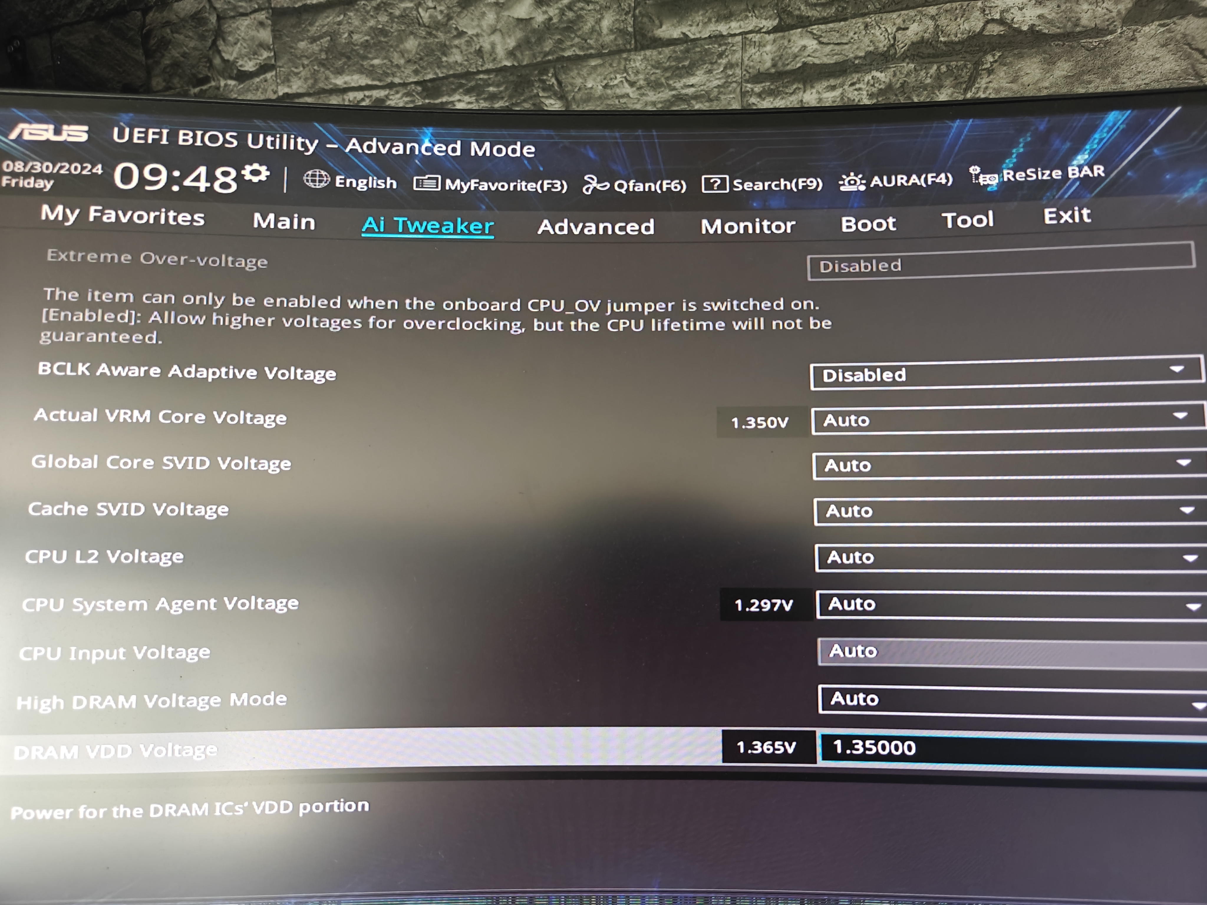

Hello Robbie R
My bios is on Intels Default see attachements mabye there is a setting incorrect.
My PSU is a Coolermaster 750W MWE Gold
For the measuring software I used XTU and GPU Z to see the temps and for stress testing I used Cinebench multi core and single core and this website https://mprep.info/gpu/
The IMG is the bios settings
The Schermafbeelding is a screenshot of the temprature rising. Where the first part of this is 1 minute single core cinebench test and the temps go around between 60- 70c. When the temps rise to 100c it is a minute multicore test from cinebench.

Hello all,
I have tried to limit the CPU Usage to 200W and then do a stress test, see image for the results. but in shot the CPU temps do again shoot up to 100c for some reason. I did not check at 250W yet but I think it will give the same results.
Are there any other bios setting i should look at.
Could it also be that the CPU goes in to safe mode (bug or feature) because the e-cores and the p-cores will have the same clock speeds so it does not crash it self or something in that guideline?
Kind regards,
Stan Z
So I changed something else in the bios not only the first I had the long package duration power set to 200W but now i changed it so that the short package duration power is also set to 200W, the temps do rise slower and do not go all the way to 100c but still go to 90c - 95c so still pretty high
