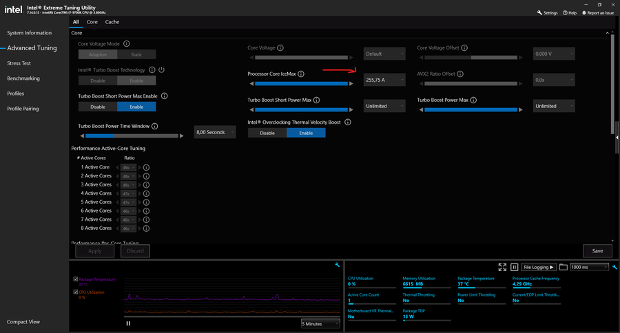

The last two versions of Intel XTU, 7.13.0.38 and 7.14.0.15, can be installed but don't work on my i7-9700K when clicking on "Optimize Power & Current Limits" or doing it manually in the "Advanced View." A popup appears, saying "Tuning error - Processor Core IccMax and Cache IccMax -> Unknown."
I've tried:
  1. Uninstalling Intel XTU, profiles, etc.
  2. Formatting the PC with a clean install.
  3. Restoring default BIOS settings.
  4. BIOS update to the last version.
  5. Last version of Windows 11 available
The only fix that worked for me was installing an older version, 7.11.1.5, which gives the impression that there's something wrong with the latest versions of Intel XTU.

Upon installing the latest version of XTU, I performed a clean installation of Windows to ensure there were no residual files or folders from previous XTU installations. Despite these efforts, the issue persists, and the latest XTU versions remain incompatible with my processor. Notably, the only functional XTU version is 7.11.1.5 as you can see below:
Following the BIOS update, I restored the default settings and the problem persists.
I am inclined to think that the issue is not linked to my computer's configuration, especially considering that it appeared after updating XTU, and even with a clean reinstall of the operating system the error is still the same.

We would like to clarify the following:
  1. Are you able to select any other IccMax value than "unlimited"?
  2. Is it only the topmost value that causes the error? Or do other IccMax values show the error?

To answer your questions 1 and 2, I switched to "Advanced View" > "Advanced Tuning" and played around with the sliders. The error only pops up when it's set to 256.00A (my max limit). But any other value, like 255.75A, works just fine and covers my PC needs.
In summary, the current workaround suits my needs, but it would be ideal if the automatic optimization could be implemented without triggering the mentioned error. Appreciate your help!

Exceeding the maximum value limit results in an error across all systems, a fact we have verified and replicated. We have documented this as a known issue that will be addressed in upcoming software updates. At present, the temporary solution we've provided is the only option available. The XTU team has been notified of the issue and is committed to delivering a resolution, although the exact timing for this is currently undetermined.
