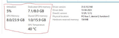

I have below configuration:
1: Processor: i9-12900K -16 Thread processor.
2: SSD: Windows OS
3: RAM: 32GB
4: Graphics: NVIDA RTX 3060Ti - 8GB
As per below image, I am not understanding  Q.1: "what is Shared GPU memory"
Q.2: GPU is 8GB. Then whay GPU Memory showing is 23.9GB.
0 Compliments
AlHill
Super utilisateur
2 818 Visites
Your processor graphics will use up to 50% of your system memory.  Thus, you have 32GB and the 15.9GB is roughly 50% of that.
Your nvidia card has 8GB.
15.9 + 8.0 is 23.9.  Why your ubuntu utility displays it as such is a question for your linux support.
