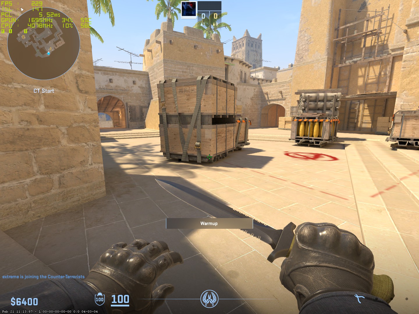

ashish_singh
2,612 Views
hallo intel support,
yes u are right let me fill the information for u
what i tried last night was disabling intel bluetooth and intel wifi from device manager to see if does anything  but i tried it today also with some changes.
the thing affecting my game and its relation with intel bluetooth and wifi.
step-1> restart ur computer or power it on (this is a only one time thing which i found to be working)
step-2> launch counter strike 2 and jump into practice match
step-3>alt+tab mid game and open device manager disable the bluetooth and wifi both(to be sure i disabled both)
after this step u enter the game and will notice that whatever changes happened has not fixed the issue. so i quit the game and returned to windows screen
step-4>now u enable both bluetooth and wifi from device manager and relaunch the game cs2
step-5> enter into practice match u will definitely see difference in crosshair movement
kindly refer to the video i am sharing through google drive and download it separately to see clarity of crosshair movement. Dont use the google drive online player.
the comparison made here is at 1:30 and 03:24  in the video
video link
https://drive.google.com/file/d/1eSgX_rX-wzgdtiRxkAIY9FdBUqNd8MG6/view?usp=sharing
 this thing only work like after restart and not like u have to do repeatedly i am still monitoring if the bad crosshair movement comes back.
so far its better like i said in last post but inaccurate
