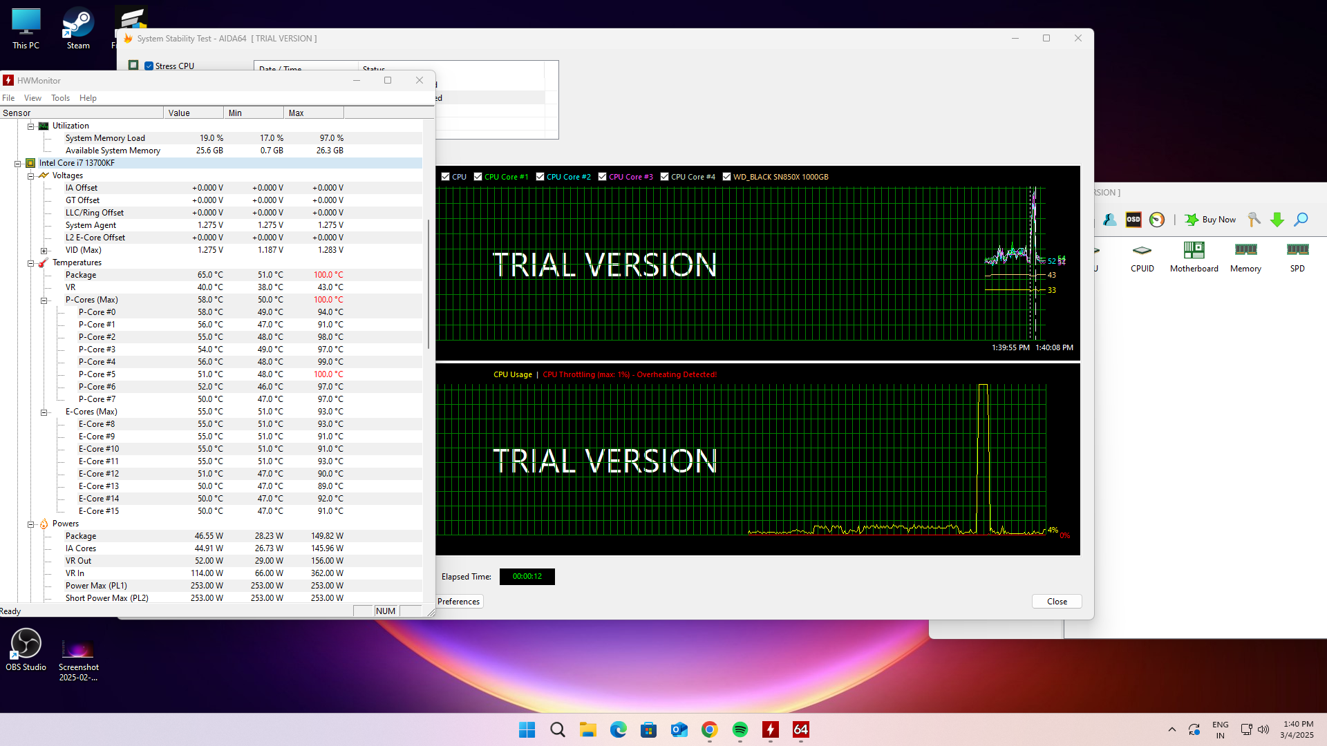

hallo new contributor,
the cpu temps at bios i have seen fluctuating sometimes 50/54 around. and same during desktop idle not doing any task. i have noticed high temp only during gaming in the previous msi motherboard and this gigabyte motherboard but like later microcode and bios update it got reduced and i am mostly on 40 watt settings so i dont know if longer i played on 125 or more wattage setting , how much temp it would cross .
i have tried stress testing on cinebench on previous msi motherboard it would go 95 degree celsius within second of hitting start. i dont remember exactly it was single core or multicore performance test but i stopped the stress test within second after seeing high temp reaching 95 - 100 on h/w monitor. i stopped stress testing since then.
at 40 watt cpu temps are normal for me. Completely ruling out cpu temps. is dependent on bios version plus cpu wattage limit set in that bios. I cannot rule that out its a dynamic thing .
thanks
The fact that you are effectively severely limiting the amount of power the processor can draw (40 W PL1/PL2) is simply unnecessary for the cooler you have. A 360 AIO would be optimal for your processor but not strictly necessary.
All I can tell you is when I swapped out my processor, I got all kinds of strange behavior...and the temps weren't the worst but not the best. I remounted my cooler and not only are my temps day and night better, all my anomalies went away, before I overclocked. And finally, I have a beast of a cooling system (expensive) but none of that mattered - because the cooler (cold plate) was not mounted to the CPU properly!
Now I would suggest you run AIDA64 Extreme stress test and select just the CPU and see what the percentage of throttling is. Do this with PL1&PL2 at default. A few percent of thermal throttling is fine, but if you're getting crazy numbers (30+ percent) will tell you everything you need to know... Or if you like, you can just run Cinebench R23 / R24 10 minute test and use HWiNFO64 and look at the average wattage the CPU is able to sustain throughout the run and thermal throttle percentages (keep in mind unless you set PL1&PL2 to the same values, then your CPU will drop to its long-term power state, PL1, which will lower your temps...56 secs by default). You have to be careful looking at just scores because in addition to cooling, different bios settings well hugely affect scores. The goal here is to see how well your cooler can handle the default temps the chip will generate. Any reserve your cooler may have would
give you theoretical overclocking headroom. To be clear, I'm not suggesting you do any kind of overclocking, just explaining a little bit how it works.
If you choose to ignore this advice, that's okay. I hope you get your PC fixed and let everybody know how it goes.. I will not edit any of my posts to save face after the facts.
P.S. I already know you're going to say you don't have any overheating issues and, I believe you, considering your starving the processor of a fraction of the power it needs to run optimally. Fixing your cooler issues is not a guarantee to fix your gaming issues... but with all due respect, you are wasting people's time. I understand that is NOT your intent and until you can show your processor can run at normal speeds and temperatures, it is insane for ME to continue helping you without that solid foundation established. I do encourage you to wait to see what other forum members and especially what Intel support says.
i downloaded the aida64 app and tested the cpu , u typed a lot of thing for me to understand but what i did a stress test for few second with auto setting where no limit for pl1 and pl2, and other time i use the pl1 pl2 125 watt for both and ran the stress test for few second. i took the screenshot and attaching it here . i hope the query get resolved with what cooling has to do with my mouse senstivity.
thanks
