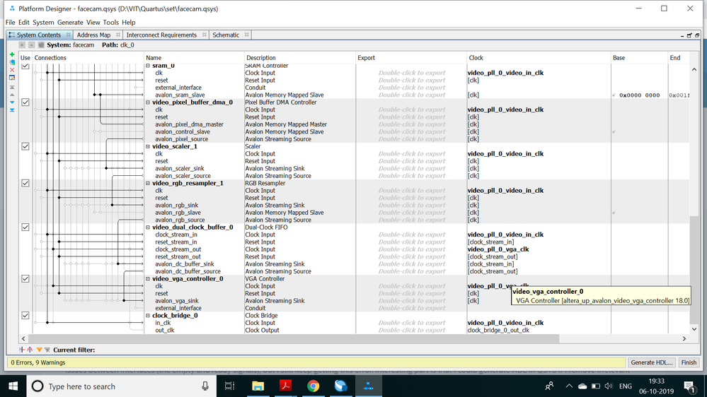

I m trying to do the design specified in the video tutorial(link above).
And i managed to connect all blocks without error. but while generating hdl it showing error like:
ERRor: avalon_st_adapter.data format adapter 0: The output interface has no empty signal, but this adapter has been configured to adapt a narrow input interface symbols per beat(1) to a wide output interface symbols per beat(3).
Pls help me to solve this error. i a mtech student. Thanks in advance.

Hi Mebin,
Please share the project let me check.

Sir i cleared the errors while generating the HDL bu changing data bits per symbol and plane. I don't know whether it will work on the DE-2 board.
