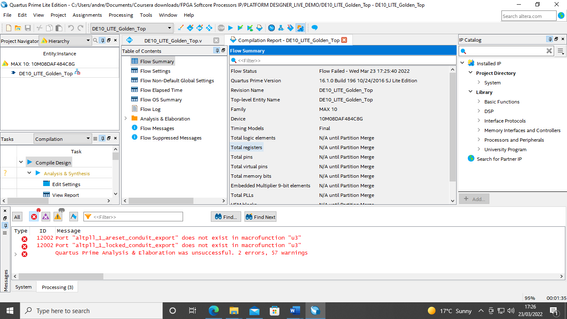

Thanks for the reply. I have tried adding the core.qsys with the DE10_LITE_Golden_Top Verilog as can be seen below but still no luck as the following error messages get shown when compilation is finished.  Let me know if anyone knows the solution?

Can you show your Platform Designer system?  Something is simply not connected correctly.

Below are the instantiations of core u3 in DE10_LITE_Golden_Top.v :
.altpll_0_c1_c1k ( ),
.altpll_1_areset_conduit_export (ARDUINO_IO[2]),
.altpll_1_locked_conduit_export (ARDUINO_IO[3])
As sstrell mentioned earlier, this is interconnection problem. I don't see ports above altpll_0_c1_c1k, altpll_1_areset_conduit_export and altpll_1_locked_conduit_export being instantiated in core.v as well as core_inst.v. May be you have to check again. There is no error at altpll_0_c1_c1k because it is not being connected yet.
