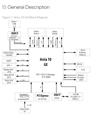

I have learned how to build a Nios II and load it through a cable to the FPGA, what I want to know is how to burn the Nios program to A10 dev kit board flash. I am reading "edh_ed_handbook-683689-666980" chapter 5.
I hope there is an example could show the procedure clear and simple.
to make my question clear, is there a tutorial to show the procedure to load NiosII program to flash and boot it successfully from there.

KellyJialin_Goh
1,708 Views
The design example is designed specifically based on Quartus 15.1 pro version and therefore if a different version is used, user is expected to be familiar with the IP upgrades.
Flashing the .hex file will be via EPCQ flash for Arria10 GX as shown as the picture below of the A10GX Block diagram.
You may refer to this link to look at the EPCQ booting flow and information: https://www.intel.com/content/www/us/en/docs/programmable/683104/current/nios-ii-processor-booting-from-altera.html
Hope this helps. Thank you.
Kelly
KellyJialin_Goh
1,706 Views
Hi David,
Here is the block diagram of the Arria10GX for you to understand more:
Hope this will help to clear your doubts.
Thank you.
Kelly
