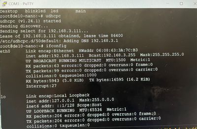

I suspect the issue is due to the IP address not being on the same network 192.168.3.111 vs 192.168.0.1 on your pc but it is strange when you have both PC and DE10 ethernet connected to the same router with different network. Could you check whether the IP is assigned via DHCP or static (defined by own ethernet settings) perhaps command "ip route list default" and see whether dhcp or static appear. If static you will need to change the IP manually or set back to dhcp. I think you could also go to your router page and see the list of devices IP connected to it with DHCP.

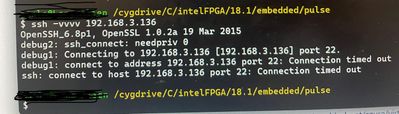

I tried the ssh command shown in the screenshot, and it says connection timed out.
<ssh -vvvv 192.168.3.136>

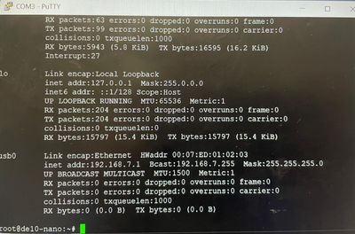

The "ifconfig" of puTTy is shown here. The IP address of de10 nano is <192.168.3.111>

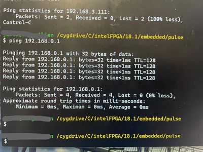

Trying to ping the de10 nano's IP address from the Embedded command shell. As you can see, it says "Request timed out". Unable to "scp" the file.
Tried pinging the IP address of my PC from my PC Embedded command shell, and it works.

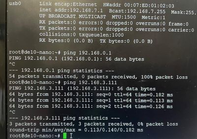

Trying to ping the IP address of my PC from puTTY. As you can see 100% packet loss.
Tried to ping the IP address of my de10 nano from puTTY, and it works.

What's the usb0 after you run ifconfig in putty? Did you connect anything else on DE10-Nano?
I am also not sure if board ip address 192.168.3.111 and pc ip address 192.168.0.1 are in the same LAN segment, you need to check this. They can't ping reach to each other if they are in different LAN segment.
There is an alternative way to copy the file, use one Ethernet cable to connect PC and DE10-Nano directly, set IP address for PC and the board, you still need to make sure they are in the same segment, then ping them, test if they can reach to each other. If yes, then you can execute scp command to transfer the file.

Thank you so much, it worked!
I checked the IP to see if it was a DHCP or static, turns out it was static.
I changed it to DHCP and then I was successfully able to SCP into the board.
