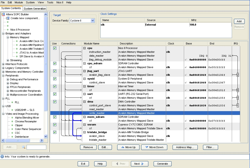

hi all,
im just a beginner trying to run memory test example code provided in nios EDS. What ive wanted to do is simply running a test on SDRAM (with dma). Ive configure the SOPC with SDRAM & dma controller. The screenshot of my sopc is shown below: https://www.alteraforum.com/forum/attachment.php?attachmentid=2385 While running the c code example, the program pass all the test but stay still when it comes to "testing memory using dma". I ran it again in debug mode and put breakpoints in certain places. What i found out is that it never get out of while(!rx_done). It seems like the dma transfer is never completed and rx_done is always 0. Here is the code snippet of the memory test (consist only the function called for dma test)/******************************************************************

can u guys advice anything that ive done wrong?maybe setting in the sopc.the connection in sopc or something. im a little confuse right now because this is suppose to be a simple memory test which i only use an example provided code in niosIDE :confused:. Any help is appreciated. Thanks~ Im currently using Altera Quartus II v8.0, Nios IDE v8.0
