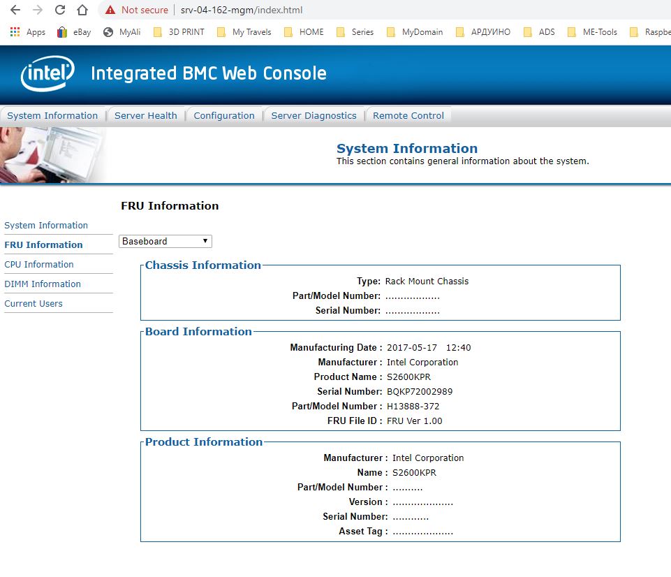

There are supposed to be 3 fans on each one of these nodes. On your BMC it shows 6 fans up and running and 6 not present. Let me ask you are there 2 nodes only on your chassis?

Hi Jose
We have about 200 of this servers. This chassis has 4 nodes as well as all other servers. Indeed it has only 3 fans but shows 6... this node’s mainboard was replaced about 1.5 years ago

Hello ODavi2,
Is this the only node showing this erratic fan info? If you access any of the other 3 nodes BMC console what do you see? Could you attach an image, please? Have you performed any BIOS updates recently? What firmware version is currently installed?

The affecter server name is srv-04-162-mgm, it’s neighbors names are srv-04-161-mgm, srv-04-160-mgm and srv-04-159-mgm .
Images are attached.

Hello ODavi2,
The debug log you attached is password protected and we do not have the password since this logs are usually used by engineering only. Even though I was able to see the FRU file ID version is v1.0. If this is the case then the BIOS firmware on this node could be really old. You can go ahead and update the BIOS to the latest v01.01.0028 with FRUSDR v1.16

Dear Jose,
This server already have all latest updates.
Pls see attached picture.
