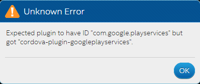

 It turns out the  XDK system automatically update my plugins.  fortunately I had a copy of the old version that I knew worked and when I tried to installed it (locally) I'm now getting this error.
"Expected plugin to have ID com.google.playservices but got cordova-plugin-googleplayservices"
so why can't i import my old version of the plugin now? (which is how I did it before)
I'm now stuck in limbo I can't install the old plugin and I can't install the new one.
so my project has stalled again :-(  any help would be great.

Did the error result in the plugin not being installed in your project? I've seen that error message but my plugin was still installed. If the plugin is not installing, then you might remove all references to that plugin from the various json files in the plugins directory (exit the XDK first). For example, you'll find a fetch.json, android.json, etc. there. Remove all references to either version of the admob plugin. I suspect the fetch.json is the culprit, but delete the references in all of those files. Then try adding in the older version of that plugin again.
BTW -- which version of the plugin are you trying to install?

the plugin was removed. The version I removed was 2.9.9 I think  I have since replace the plugin with another fixed all my code and testing it now.  The other plugin admob-google-cordova. seems to be working. just so much wasted time ( so sorry for venting ).
The version I was trying to install was : 2.7.8
Mike
