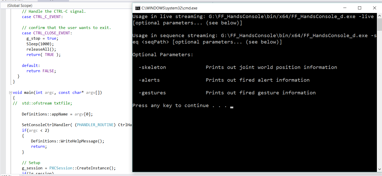

Dear sir or madam:
When I try to run "FF_HandsConsole" from VS2012, the problem in image will happen.
 内嵌图片 1
It looks like argc in main is not enough. However I have no idea how to fix it. This problem does not happen to other sample code and I didnt change any code.
Could you please give me some clue?
Best.
Xusheng_L_Intel
427 Views
I do not know what the exact issue you have. You can run this sample app like
C:\Program Files (x86)\Intel\RSSDK\sample\FF_HandsConsole\bin\Win32>FF_HandsConsole_d.exe -live
or
C:\Program Files (x86)\Intel\RSSDK\sample\FF_HandsConsole\bin\Win32>FF_HandsConsole_d.exe -live -skeleton
