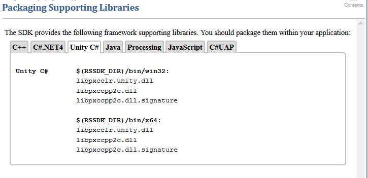

Hi All,
I am a game developer with realsense. After the game finished, I wanted to create an installer. but when installed on another computer, the game can not be executed because there is no realsense runtime on the computer. My question, how when installing a game realsense by installing the  realsense runtime if not done there? thx

You need include the RealSense runtime in your app package. You can find detail info @https://software.intel.com/sites/landingpage/realsense/camera-sdk/v1.1/documentation/html/index.html?deploy_application_deployment.html

Does runtime installed just insert the file :
$(RSSDK_DIR)/bin/win32:
libpxcclr.unity.dll
libpxccpp2c.dll
libpxccpp2c.dll.signature
$(RSSDK_DIR)/bin/x64:
libpxcclr.unity.dll
libpxccpp2c.dll
Or do I have to do something else? thx.

I've found the solution of my problem:
https://software.intel.com/en-us/articles/add-realsense-runtime-to-app-installer
