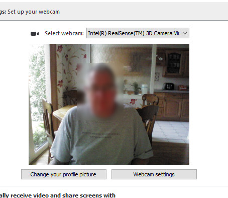

Daron_B_
5,787 Views
Driver processed as you recommended, removed both the device drivers and the Intel software from control panel, rebooted, all reinstalled and then rebooted. As you can see still a black / white image in the 'Hello' wizard:
The above is with the camera 3 feet away from me, with full daylight and additional 3-buld overhead light. As you can see still a black / white image and no recognition.
Do you see a colour image in that configuration screen?
