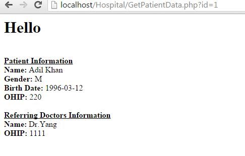

Could someone please help me, I tried to create a simple application that can view information from a database. It is working in the emulation mode, but when I try the application on my device it does not work. I am new to Intel XDK, any help will be greatly appreciated.

Hi Adil,
I think that the problem is that in your device this won't work:
http://localhost/Hospital/GetPatientData.php
This url should be the server's one.
Diego

It's probably related to the whitelist settings on the Projects tab, but it's hard to say precisely. Did you try some of the demo/sample apps to see how they are configured? Especially the whitelist settings.
Also, try using the Debug tab, it will provide a more accurate view of running your app on a real system. See this doc for even more options > https://software.intel.com/en-us/xdk/docs/intel-xdk-debug-and-test-overview

Thanks Paul for the response.
I have tried the whitelist settings. I will upload some pictures of what I have done, so that the problem can be a bit more clear.

Hi Adil, Deigo's comment is the most likely cause of your troubles. Also, see this blog for some useful getting started hints regarding how a Cordova app differs from a web app > http://blogs.intel.com/evangelists/2015/12/31/five-useful-tips-on-getting-started-building-cordova-mobile-apps-with-the-intel-xdk/

Thank you Diego and Paul, I have resolved my problem. I had to remove the hidden frame part, change the whitelist settings, and change the local host to my IP address in the html portion of the code.
