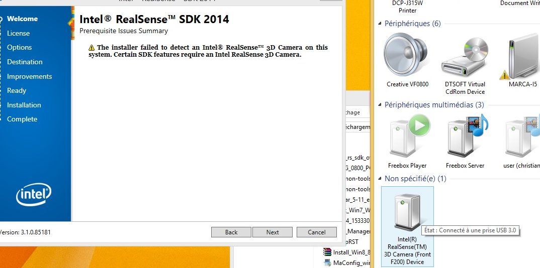

I've received my Realsense camera 1 week ago. I tried install the SDK with the offline package  intel_rs_sdk_offline_package_r_2.0.30.73832 but the camera isn't recognized at all.
I decided to buy a new computer with a 4th generation Intel processor. First installation after a fresh Win 8.1, the camera and the samples works. Unplug/plug the camera, the device and samples binaries doesn't work anymore. Even after a reboot of the machine (many tries with camera plugged, ad unplugged). I reset my computer, and install again Win 8.1. The camera works randomly : (around 7 install of win 8.1 for making the camera works 3 times at the very first SDK installation)
Following the tutorial of Marty G. I installed Win 10 preview to make a try. It works once, same problem than with Win 8.1 OS. Reboot and re-plug  make windows not recognize the device.
I tried both Windows version with the new SDK installer version :   3.1.0.85181, exaclty the same problem.

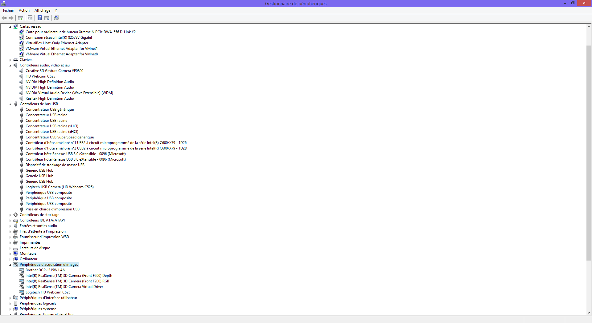

I looked up the drivers used (in device manager) for the 3D camera RGB, and 3D camera Depth (Imaging Devices categorie). For both, drivers are : CtClsFlt.sys, ksthunk.sys, usbvideo.sys. And the 3D Camera Virtual Driver uses : CtClsFlt.sys, ksthunk.sys and RealSenseDCM.sys.  Sometimes, after a SDK re-installation on Win 10, when the RGB and Depth Camera appears in the device manager, driver listed is only : usbvideo.sys. In this case too, Firmware cannot be installed, and samples binaries failed during init step.
On Win 8.1, after a new installation, RGB and Depth Camera, arn't visible, but they can be shown using "show Hidden devices" in the menu of device manager. Looking at the drivers, they are all here (3 drivers for the 3 device in Imaging Devices) but windows doesn't want to recognizes the devices. In properties, error message is : << The device isn't connected to the computer, error code 45 >>. Solution suggested by Windows : plug/unplug -> That doens't works.
I cannot start working on my ideas, because, event if the camera start working on a fresh Windows installation, first reboot or unplug makes it stop.

USB controllers names that may interest you are :
 - Intel(R) 9 Series Chipset Family USB Enhanced Host Controller - 8CAD
 - Intel(R) 9 Series Chipset Family USB Enhanced Host Controller - 8CA6
 - Intel(R) USB 3.0 eXtensible Host Controller - 0100(Microsoft)
Screenshot attached is the complete list of all USB controllers from the device managers.
These tests and info are made on Win10 technical preview. I'm starting a new win8 installation to make the same tests on Win 8.1 and posts any other information if there is a change.
