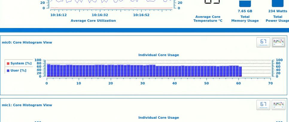

Method 2: Using micsmc
1. Start your benchmark and then on another terminal launch 'micsmc' as follows:
micsmc &
Here if you change the display(view) mode to "Go to Core Histogram View" you will be able to see the real time core utilization on your coprocessor card as follows:

Hi Chao,
As per your note earlier, It looks like you are trying to run multi node version of linpack (in mp_linpack directory) rather than single node openMP version(in linpack directory). The multinode version requires additional configuration as given in the runme_hybrid_mic script. Some of the important points to note from the script are:
# USAGE NOTES: This script should be uploaded to MIC and executed there, NOT on host CPU. # Before running this script on MIC, please upload/copy the following necessary files to MIC: # # 1. HPL input file (scp HPL_hybrid.dat mic0:/tmp) # 2. HPL binary for MIC (scp xhpl_hybrid_mic mic0:/tmp/xhpl_hybrid_mic) # 3. OpenMP run-time library for MIC (libiomp5). Change the path set to LD_LIBRARY_PATH below accordingly. # 4. mpiexec.hydra process manager and MPI run-time libraries (Please follow the instructions documented at <intel mpi installdir>/doc/ for installing Intel MPI on MIC)
So before running the multinode version, can you please run the single node version(runme_mic) from the directory- /opt/intel/mkl/benchmarks/linpack ( default). I have listed steps to run linpack - native on a coprocessor in one of the notes above. Once you run the script runme_mic you can verify number of threads using micsmc or by looking at the output (lin_mic.txt).
