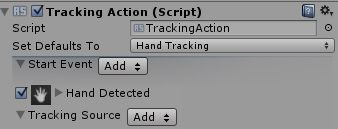

Hi everyone,
You may come across situations in your Unity projects with the RealSense camera where you want to be able to switch the SDK's 'Action' scripts (such as TrackingAction and TranslateAction) on and off at will, and you need more options to do so than the built-in 'Start' and 'Stop' rule settings can provide.  There's good news if you are in that situation - you can control the on-off state of the C#-based Action scripts with scripting!
To do this, we need to create a new C#-format script   Whilst JavaScript can also be used to activate and deactivate other JavaScripts at will, it does not work with C# scripts like the Action ones.
Important note: You must place your script file inside the same Unity object that the Action script that you want to turn on or off is located in, otherwise Unity will not be able to locate the exact Action script that you want to affect.  This is the same principle as the 'SendMessageAction' SDK Action script, which must also be in the same object that it is making reference to..
Important note 2: when creating a new script file, ensure that you select 'CSharp' from the script creation interface's drop-down menu, otherwise you may create a JavaScript type file and find that your C# script will not run.
If you are in the habit of mostly using JavaScripts in your project, also make sure you switch the script setting back to 'JavaScript' as soon as you have finished making C# scripts or you will end up creating C# script files when you meant to make JavaScript!
So, continuing on ... C# is a bit more complicated than JavaScript, so I will post the code for my script and then explain what each part does.

Finally, in the next line, we can tell Unity whether to enable or disable the targeted Action script.
To activate the Action script, we use:
  ScriptOnOff.enabled = true;
And to deactivate it, we use:
  ScriptOnOff.enabled = false;
As usual, replace our variable name 'ScriptOnOff' with the name of your own custom variable name when writing your own script.  E.g.
NAMEOFVARIABLE.enabled = true;
You should create two separate versions of the script, one with the True statement in it and one with the 'False' statement in.  This will enable you to turn an Action script off, turn it back on and then switch it off again.
We called our pair of C# scripts 'TrackingAction_On' and 'TrackingAction_Off.'
Having got to this point, you will now be ready to run your project and test out the new scripts.
Ensure that your two on-off scripts are inactive by default by clicking on their tick-boxes to remove the ticks and make them empty.  Also ensure that the Action script has a tick beside it to show that it is active right from the start of running the project.
Select the object that your scripts are contained within and then use the triangular 'Play' run-button in the Unity editor.  This will let you access the script settings in the Inspector whilst the project is running.
Now left-click on the tick box beside your 'off' script.  The Action script's tick box will immediately un-tick, meaning that the Action script is now switched off and is no longer tracking your body!
Un-ticking the 'off' script and ticking the 'on' script turns the Action script back on.

		ScriptOff_3.enabled = false;
In our example, the scripts that we are seeking are all located inside the same object.  If you want to target scripts that are in different objects then you just have to change the name of the object in quotation marks after 'GameObject.Find.'
For example:
ScriptOff = GameObject.Find("Shoulder Blade Right - Rotation Joint ").GetComponent<TrackingAction>();
		ScriptOff.enabled = false;
		ScriptOff = GameObject.Find("Shoulder Blade Left - Rotation Joint ").GetComponent<TrackingAction2>();
		ScriptOff_2.enabled = false;
		ScriptOff = GameObject.Find("Left Lower Arm - Rotation Joint ").GetComponent<TrackingAction3>();
If you want your script to activate the targeted scripts, such as TrackingActions, then change the word 'false' to 'true':  E.g
		ScriptOff_3.enabled = true;
You do not have to have all-enable and all-disable scripts.  Depending on the needs of your project, you could have some scripts be disabled and some of them enabled.  E.g:
		ScriptOff = GameObject.Find("Shoulder Blade Right - Rotation Joint ").GetComponent<TrackingAction2>();
		ScriptOff_2.enabled = true;
