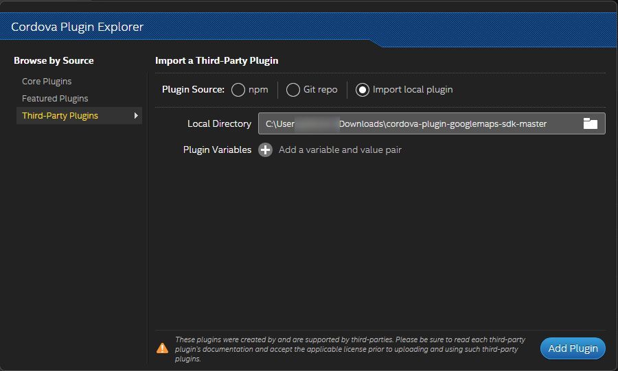

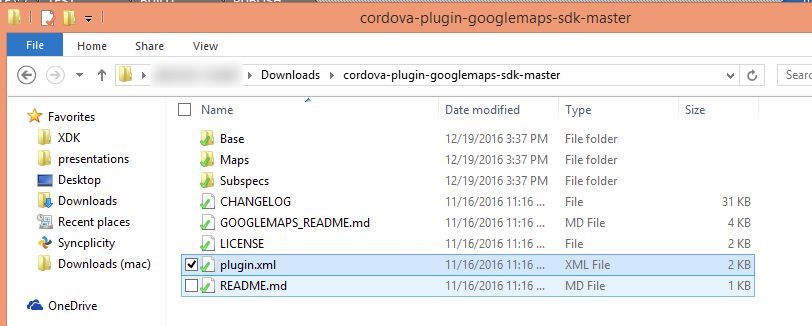

The plugin you are trying to install has a dependency on another plugin (look inside the plugin.xml file), which does not get resolved properly during the install. So you need to first install the plugin that satisfies the dependency, then install the plugin that needs the dependency.
The dependency plugin is not published in the Cordova NPM registry, so you have to install it as a git repo, as follows:
Then you can add the first plugin by ID, since it has been published to the Cordova NPM registry:

Do it as I have done, above. First install the "dependency" plugin by downloading a ZIP of the repo, unzipping it, and using the "import local" option to add it to your project. Then use the NPM import option. Both are shown in the images in the order you should do them.

Try using the local import technique for both. Remember to import the dependency plugin first.

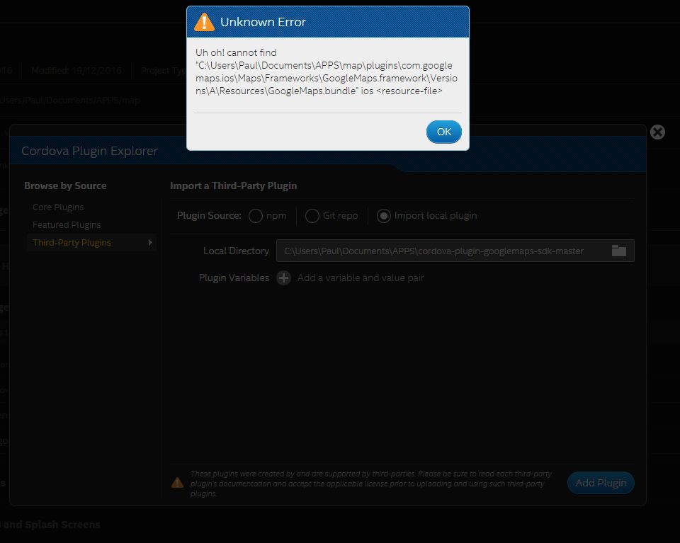

I've created a new project and downloaded the dependancy plugin from https://github.com/mapsplugin/cordova-plugin-googlemaps-sdk
Extracted and tried to install the plugin locally. I get the error below...

When you look are plugin file structure there is no Resources folder within the 'Versions\A' folder

Adding the Repo URL with the Git repo option, adding my variables and Uh ! , the same error :,c
PaulF_IntelCorp
2,757 Views
It looks like that plugin is using a symbolic link, which is failing on Windows (I tried this on a Windows 8.1 system). This is not something I believe the XDK can detect and automatically fix for you, it is a problem with the way that plugin is configured. Using symbolic links is not guaranteed to be transportable between multiple filesystems and operating systems.
If you modify the copy of the plugin.xml file to be similar to this:

it will work.
Following are the steps I went through. On the last image you can see that it is a Windows machine the XDK is running on. It's only necessary to download and modify the dependency plugin (as I have changed it above) and then you can use NPM to install the other plugin.
