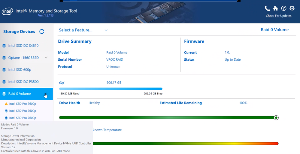

Is there a way to collect SMART information for NVMe that has RAID configured with VROC?
I would like to know when to replace the NVMe drive.

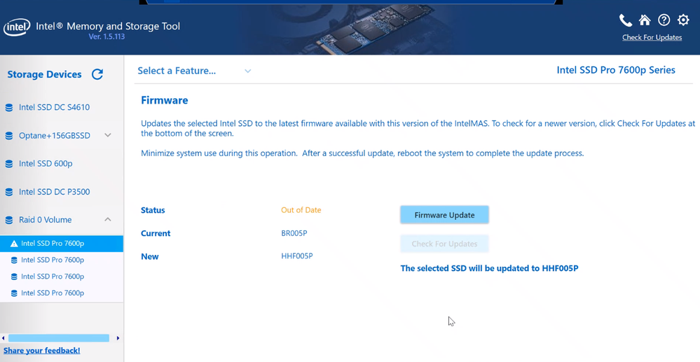

Piggybacking on this question because it is related. Is there a tool that can update Optane drive firmware when configured in VROC?
I was surprised to see that I can indeed update 800P firmware when in Optane acceleration mode through Intel's firmware tool, but it can't see into my VROC array.

4- To answer your questions:
it depends a lot on the OEM compatibility and if the drives are connected or not directly to the board. If you have Intel® SSD's you need to use the:
 Intel® Memory and Storage Tool (GUI)
https://downloadcenter.intel.com/download/30161/Intel-Memory-and-Storage-Tool-GUI-
Or the:
Intel® Memory and Storage Tool CLI (Command-Line Interface) https://downloadcenter.intel.com/download/30162?v=t
To check the SSD life remaining or to update your SSD firmware if they are recognized as shown in the following screenshots:
- If you have third-party SSDs on your VROC configuration, please contact the SSD manufacturer to check if their tool is compatible with VROC.

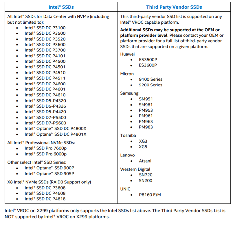

-To answer BHarr8 question:
The Intel® Optane™ SSD 800P Series is not a supported SSD, and we do not recommend using it with VROC.
Based on the Intel® Virtual RAID on CPU (Intel® VROC) Supported Configurations article:
https://www.intel.com/content/www/us/en/support/articles/000030310/memory-and-storage/ssd-software.html
The supporter NVMe SSDs are the following:
