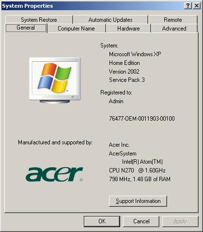

>>...The EIST_TRANS event isn't available on sandbridge systems, just core-2 and atom based systems. Here are two screenshots which simply demonstrate how EIST works on a system with Intel Atom N270 CPU: [ 1 ] eist1.jpg [ 2 ] eist2.jpg

In the 1st screenshot EIST is in effect and you see 798MHz.
