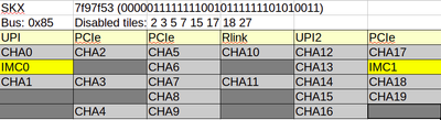

I am trying to unveil topology of my SKX server. This is a 40 core server with hyperthreading disabled. I am attaching my lscpu output as well, if that would be of help regarding my following questions.
I already know CHA locations thanks to work of @McCalpinJohn . I basically read CAPID6 registers on my system. I have two sockets on my system and they both have their 8 tiles disabled, meaning that they have CHAs from 0 to 19, in total 20; considering that there are 28 tiles. Below I attached image of my two sockets and their corresponding CAPID6 register value. I believe 20 enabled tiles (CHAs) per socket is accurate since there are 20 cores per socket and there is a one-to-one relationship between cores and CHAs.
Is my interpretation of CAPID6 register and deriving CHA numbering correct?
Assuming that my CHA was correct, I focused on deriving cha-to-core relation since that would yield me the entire topology information. For this purpose, I have configured my uncore registers to measure traffic direction across each mesh stop. I based my work on @McCalpinJohn and I explicitly made use of his codebase https://github.com/jdmccalpin/periodic-performance-counters Then I kind of made a sanity check. First of all, I have read all traffic counters in each direction just before fetching data from memory. Then I bound my thread to core 0 and read 2GB of data from the RAM (I made sure to flush it from the cache hierarchy before doing that), and read traffic counters just after again. Thinking that probably core0 is co-located with CHA0 and I was hoping to measure way more UP value than DOWN value in CHA0 considering that CHA0 is above 2 IMCs but this was not the case. Below image is taken from @McCalpinJohn 's "Mapping Core and L3  Slice Numbering to Die Location in Intel Xeon Scalable Processors" technical paper. And also, is below image really correct? I thought that meaning of left and right changed in alternating columns according to John McCalpin's findings.

There is an updated version of the technical paper on locations of cores and CHAs in Xeon Scalable Processors:  http://dx.doi.org/10.26153/tsw/13119.  Figure 3 (that you included above) has been slightly updated in the newer version, but in either case it shows the *expected* traffic on the mesh -- before the realization that the meaning of left and right swaps in alternating columns.
The exact PerfEvtSel values that I used for the CHA mesh data traffic counters were:
  • cha_perfevtsel[0] = 0x004003b8;     // HORZ_RING_BL_IN_USE.LEFT
  • cha_perfevtsel[1] = 0x00400cb8;     // HORZ_RING_BL_IN_USE.RIGHT
  • cha_perfevtsel[2] = 0x004003b2;     // VERT_RING_BL_IN_USE.UP
  • cha_perfevtsel[3] = 0x00400cb2;     // VERT_RING_BL_IN_USE.DN
The CHA unit Filter0 register is not used for these "Common Mesh Stop" events.  I also usually set Filter1 to 0x3b, but have not tested whether that makes a difference for these particular events.
The documentation is definitely confusing -- it clearly involves cut-and-paste from the documentation for the earlier ring-based systems (going back to at least Sandy Bridge EP).  You can ignore the "even" and "odd" sub-types for the moment -- each mesh stop is only able to receive on either even-numbered or odd-numbered cycles for the horizontal links (and same for the vertical links), but to count total traffic it is easiest to count both.
Core 0 is co-located with CHA 0 on every system I have tested.  The Core0/CHA0 pair is located in the upper left corner unless CAPID6 bit 0 is clear, so that is usually a good choice for testing to make sure the counters work.
There is no guarantee that the properties I have seen on TACC systems also apply to systems from other vendors.  Intel does not publicly disclose the mechanisms used to re-number the various units on the chip, so it is not clear how much of the observed patterns are due to requirements of the hardware, inheritance from the Intel reference BIOS, or just a lack of interest by the vendors in changing the BIOS options.
