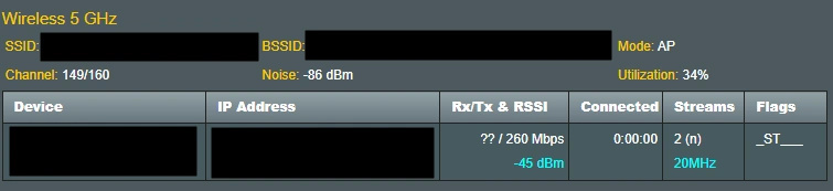

I tested some channels in 5.8 GHz (169, 173, 177), but it seems AX210 can't connect to the network which operates in these channel, even they are only a part of the network. Also I have no idea if newer devices (BE200, or others) has fixed this issue or not.
Here is my test result, the tested network are operated in 160 MHz:
1.Control channel was set to 169 or 173 or 177, adapter can't find the tested network.
It's expected behavior.

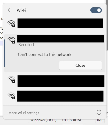

2.Control channel was set to 149 or 153 or 157 or 161 or 165, adapter can find the tested network, but when trying to connect it said it can't connect to this network.
When using other devices (such as smartphone), it can connect to the tested network with 80 MHz (control channel 149, 153, 157, 161) or 20 MHz (control channel 165). I think it's an issue, it should be work even 169 - 177 is in disallowed channel list.
Feel free to contract for more information, thanks.

The adapter should work in 80 MHz (149, 153, 157, 161) or 20 MHz (165) when router operating on 160 MHz rather than failed. In fact, AX210 connected successful when router operating on 80 MHz (149, 153, 157, 161) and 20 MHz (165). Please read as below point 5.

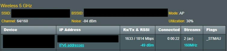

5.Have checked your router configuration and consider using channels 36-64 or 100-144 for better AX210 compatibility with 160MHz?
Yes, it's actually what I did. Both 36 - 64 and 100 - 128 work fine. I posted this issue which wants to help to improve Intel adapter compatibility.
Please review connecting information in the attachment of 36 - 64 and 100 - 128 (132 - 144 can't be used in 160 MHz mode) settings, already remove some hardware serial numbers and network addresses.
(Please note that it seems AX210 has connected in <AX210_149-177_Router_02>, but it showed failed in <AX210_149-177_Windows> indeed.)

Hello chengr28,
Kindly proceed to update Intel AX210 Wi-Fi driver to the latest version (23.170.0.1) following clean installation process.
Why the Intel AX210 Cannot Connect at 160MHz:
- The router is currently configured to use 160MHz bandwidth with channels 149-177.
Channel Compatibility Issue:
- Intel AX210 can detect the network because it uses channel 149 (which is supported) to broadcast network information
- However, the 160MHz configuration spans into channels 169-177, which Intel AX210 doesn't support
Supported Channel Ranges for Intel AX210:
- Supported for 160MHz: Channels 36-64 and 100-128 only
- Not Supported: Channels 169-177 (UNII-4 band)
Why Other Devices Work:
- Newer smartphones (released after 2022) support the UNII-4 channels (169-177) that your Intel adapter cannot use
Solution - Router Configuration Change:
To resolve this issue, try to change router's channel bandwidth setting from "160MHz" to "Auto":
- This allows your Intel AX210 to connect at 80MHz instead of 160MHz
- The connection will use only the supported channels (149, 153, 157, 161)
- Will still get good performance, just at 80MHz instead of 160MHz
This change will ensure compatibility while maintaining a stable connection.
If further clarification is needed, please let us know.
JeanetteC.
