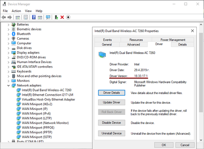

Edit: I noticed something strange:
In the events I see the following:
Version of the driver: 17.15.0.5
But in Device Manager I see this:
I installed version 18.33.17.1 from Lenovo's website.
Which version am I using? 17.15.0.5 or 18.33.17.1?
