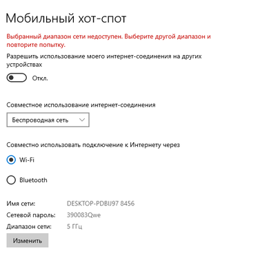

well it seems like ax200 lets hotspot 5GHZ only when recieveng 5GHZ wifi from certain chanels only
i am from Russia and it didn't work for me on chanels 40-48 (theres no limitations in Russia to hotspot 5ghz or any diapazone)
But then i have changed region in my router to north Korea and get able to choose chanel 149, ax200 allowed to hotspot 5GHZ
it is 100% driver limitation by intel
South Korea **
