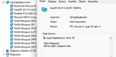

My wifi device first gave this error in 2023, I solved it somehow and it started again last week, I couldn't fix it no matter what I did, I installed the latest driver, I removed the device with the driver, I installed old drivers, it works occasionally, it turns off again after 5 minutes.
Section of your SSU
"Intel(R) Wi-Fi 6 AX201 160MHz" Availability:"Running or Full Power" - "Caption":"Intel(R) Wi-Fi 6 AX201 160MHz" Link:"http://www.intel.com/content/www/us/en/search.html?keyword=Wi+Fi+6+AX201+160MHz" CoInstallers:"Not Available" Default IP Gateway:"Not Available" DHCP Enabled:"Yes" DHCP Lease Expires:"Not Available" DHCP Lease Obtained:"Not Available" DHCP Server:"Not Available" Driver:"Netwtw10.sys" Driver Date:"03.03.2021 12:00 ÖÖ" Driver Path:"C:\WINDOWS\system32\drivers\Netwtw10.sys" Driver Provider:"Intel" Driver Version:"22.40.0.7" ETrackID:"Not Available" Index:"0004" INF:"oem8.inf" INF Section:"Install_GEN_QSR_HrP_201_AX_2x2_WinT" Install Date:"Not Available" Installed:"Yes" IP Address:"Not Available" IP Subnet:"Not Available"

Your driver version is not the latest. Since you have a dell and dell uses proprietary drivers this is probably your problem.

Hello Carmona,
I am facing similar issue with my DELL laptop since 2 to 3 years. I tried all the solution as listed in the chat discussion. i am currently using the workaround as LAN cable. But this should not be the solution.
I would request to check for the solution for the wifi driver .
Intel(R) WiFi 6 AX201 160MHz --> Driver not working
