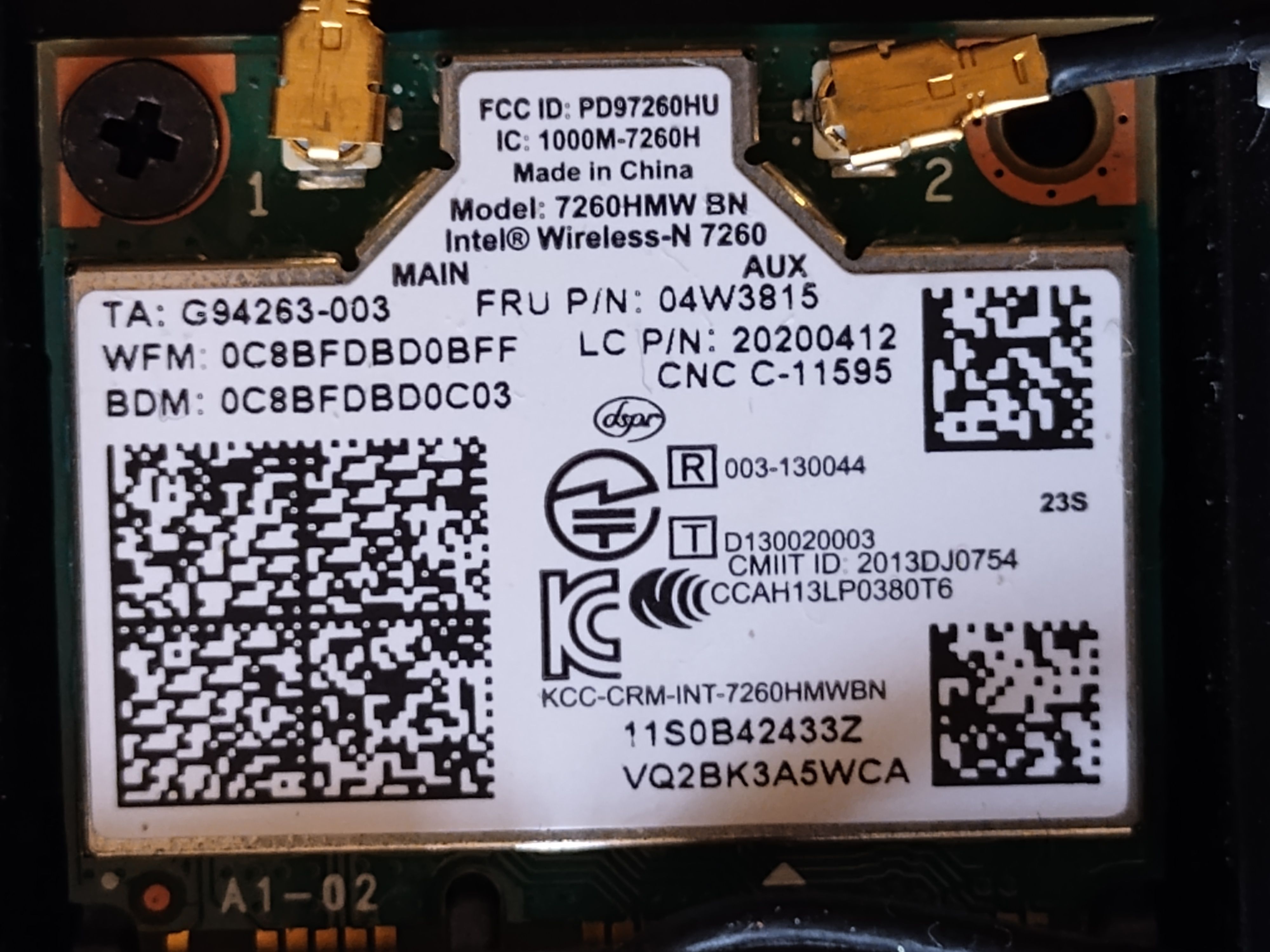

I recently purchased an older IBM Thinkpad that has the Wireless n 7260 Wifi card in it and it is running Windows 11. The card is model number 7260 HMW BN I am having problems with connecting to the internet with the Arris modem/router at my house. It connects with the router but does not have internet ? The laptop works fine at my business with a Verizon router.
I am not sure if it is a problem with the driver or something else. The present driver is version 17.0.0.34 and windows says that it is up to date.
I have attached a picture of the adapter label.
Any suggestions are appreciated.
Bill

The final Wireless and Bluetooth drivers for this adapter are included in the 21.10.1 Release packages. The Wireless driver is the *only* one that includes the fix for interoperation with WiFi6 routers.
The bad news is that, because Intel has discontinued this adapter, support for driver download is gone. The good news is that I saw this coming and backed up all of the driver packages for the discontinued adapters. I have these files in a share and you can download from there. You can access this share from here: https://1drv.ms/f/s!AtacZBU04mo-j-tQ34BdSDv6y1BFsg. There you will find subfolders that provide the last driver packages for the various adapters. These are Windows 10 drivers; hopefully they will install on Windows 11.

Thank you. I guess its worth a try. Do I just download that file to my computer and then use it to update the driver ?

Should I download all of them or only the two associated with Win10 ? WIFI 21.10.1 64 WIN10EXE and BT 21.10.1 64 WIN10EXE
Also, do I just double click on them to run or go through the adapter section where it says to update driver ?
Scott,
Looks like that did the trick !!! I cant thank you enough ! It was driving me insane
