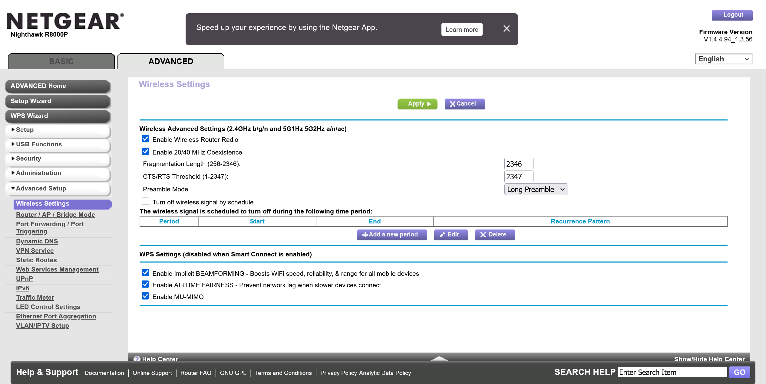

I'm enclosing a copy of the wi-fi settings from my Netgear R8000P Nighthawk router.
Apparently the router doesn't support W-Fi 6 but I still don't understand why the tab Energy Saving tab is missing.
If that tab had been present, I would have been able to prevent the computer from disabling the network connection.
Microsoft's community has similar challenges with a Realtek adapter where the same tab is missing.
Eric

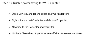

The link apppears to be obsolete but brought me to a Microsoft page: https://support.microsoft.com/en-us/windows/fix-wi-fi-connection-issues-in-windows-9424a1f7-6a3b-65a6-4d78-7f07eee84d2c#id0ebh=windows_11
There, I found an interesting piece of advice as seen below:
This advice would solve my problem if only there was a Power Mangement tab on the adapter's properties page.
Regrettably, this tab is not present in Lenovo's driver and the Intel driver.
I have also been in touch with Lenovo support. So far without a viable solution.
As far as I can see, the problem is due to the missing Power Management tab.
Are you able to find out why that tab is not present for this network adapter?
How else can I disable power saving for Wi-Fi adapter?
