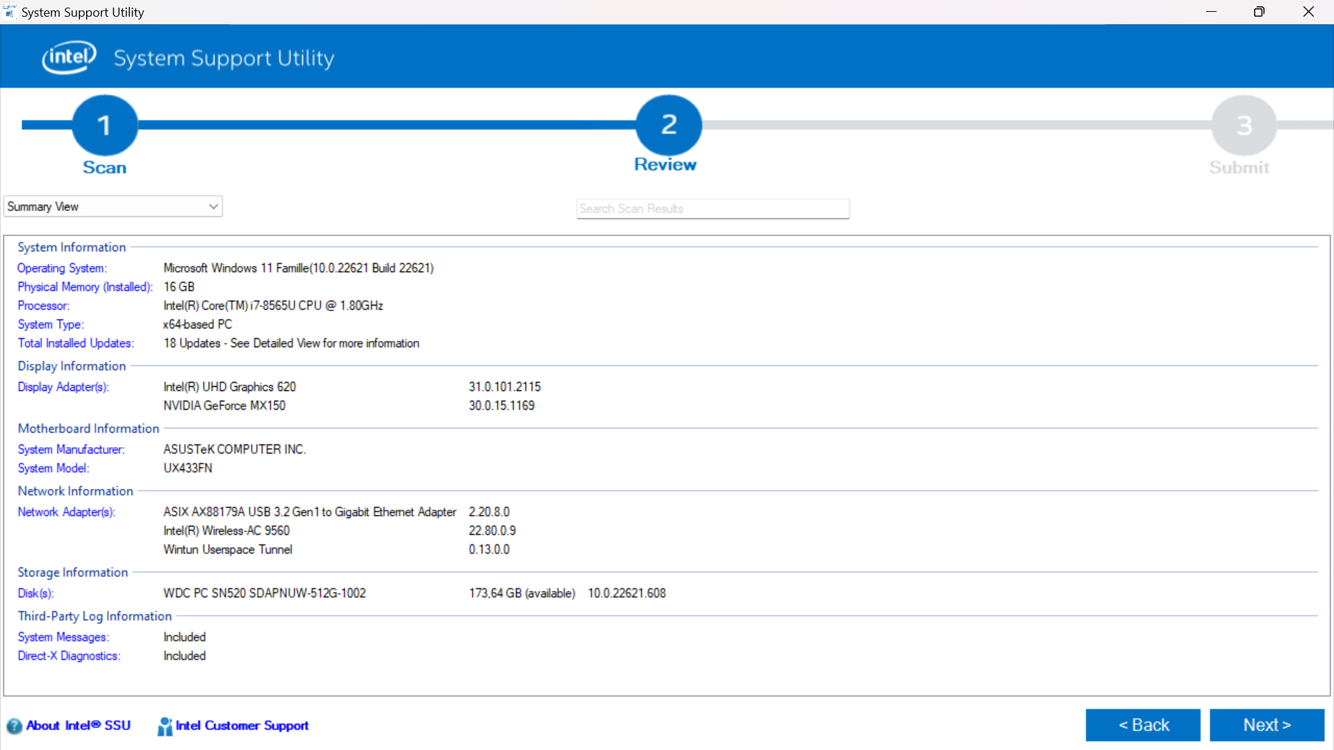

I have an Asus laptop with an intel r wireless AC 9560, the Ac 9560 stopped working code 10.
I am running on windows 11 now.
I have installed the intel driver and support assistant and tried to Download the latest driver but after several tries it says attempt failed.
I send here the support report from the assistant.
Can you please Help?
PS: I have tried to reboot the device from the device manager and reboot the BIOS to default settings.

Please attach the SSU report in English language so we can verify further details about the components in your platform, check all the options in the report including the one that says "3rd party software logs":

Hello MOOTAZ, You are very welcome, thank you very much for confirming those details and sharing the pictures.
In reference to the SSU report, from the picture you shared, please select "Next", then "Save" It will generate a document/file for you to save locally on your computer. That is the file needed for us to be able to verify additional details about your configuration.

MOOTAZ, You are very welcome, thank you very much for providing the SSU report.
Based on the information shown in the SSU document, the wireless driver version currently installed on your computer is 22.80.0.9.
It is important to mention that we always recommend to install the wireless driver provided by the manufacturer of the computer, since that driver was heavily customized by them to work with your specific platform.
I looked on ASUS website and the latest wireless driver version they have available is V21.0.0.2990. Please try a clean installation of that driver following the instructions in the links below:
