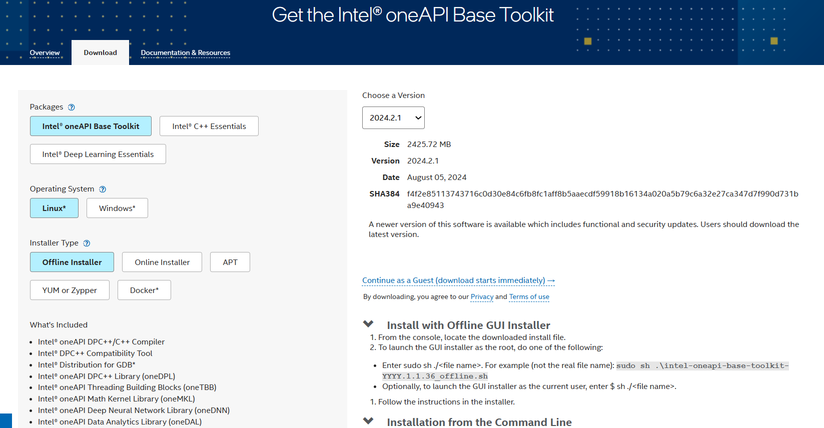

Hello mhvg1994,
Please be informed that, on our end, we are able to successfully install all versions currently available on the Intel® oneAPI Base Toolkit website. We are also able to access all the dropdown options currently available on the website. Please try clearing your browser's cache and cookies, and consider accessing the Intel® oneAPI Base Toolkit website in an Incognito window.
Previously, the Intel® Fortran Compiler Classic (IFORT) was a part of Intel® Parallel Studio XE. However, after the transition, both the Intel® Fortran Compiler Classic (IFORT) and the Intel® Fortran Compiler (IFX) are now part of the Intel® HPC Toolkit. Additionally, a standalone version of these compilers is also available.
We would also like to inform you that Intel® announced the deprecation of the Intel® Fortran Compiler Classic (ifort) in November 2023, with plans to discontinue it in late 2024 (link). The last planned version of ifort, 2021.13.0, was released alongside Intel® oneAPI version 2024.2.0 in late June 2024. Following the release of Intel® oneAPI 2025.0 in the last quarter of 2024, ifort was removed from free downloads. However, for customers with active Priority Support, ifort remains available through the Intel® Registration Center (IRC) as a prior version download.
For more information refer to the link: https://www.intel.com/content/www/us/en/developer/articles/release-notes/oneapi-supported-product-versions.htm,
Intel® oneAPI users with active Intel Priority Support can access older versions via a secure portal you gain access to as part of your support subscription.
FAQ's Priority Support Link: https://www.intel.com/content/www/us/en/developer/get-help/faq-priority-support.html
Please find the below attachment for your reference.

Of course, when I got home and tried it again, the download option swapped to the right version... Although I did have to use Firefox on my Mac.
When you say 'Following the release of Intel® oneAPI 2025.0 in the last quarter of 2024, ifort was removed from free downloads', do you mean that the 2024.2.1 version listed on the downloads website doesn't actually contain ifort? If so, is there no other way to get it?
