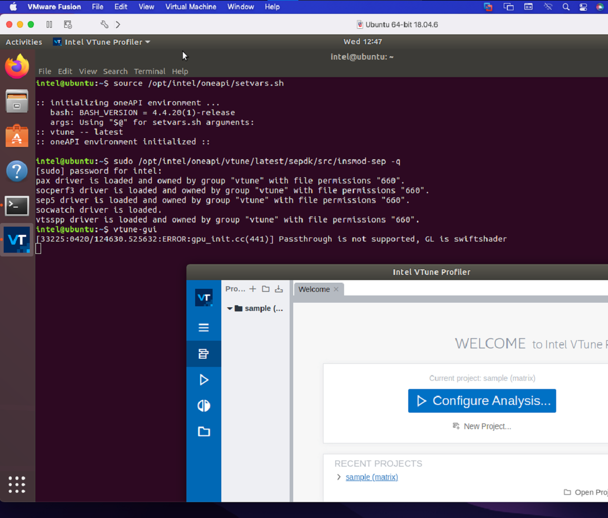

I'm new to VTune, and am running it in a Ubuntu VM using VMWare Fusion on Mac OS X Monterey.
After installing Intel VTune Profiler 2022.1.0 on Ubuntu 18.04, I was able to run and use the VTune gui without encountering errors when launching it. However, since I did get errors about not having kernel debug files, I installed the kernel debug symbol packages (linux-image-5.4.0-107-generic-dbgsym) using apt-get.
After installing the kernel debug symbol files, I'm now getting the following errors when running vtune-gui.
ubuntu@ubuntu:~$ vtune-gui
[2414:0415/122324.136712:ERROR:angle_platform_impl.cc(44)] renderergl_utils.cpp:188 (ClearErrors): Preexisting GL error 0x00000500 as of ../../third_party/angle/src/libANGLE/renderer/gl/TextureGL.cpp, setImageHelper:256.
[2381:0415/122327.011769:ERROR:cert_issuer_source_aia.cc(104)] AiaRequest::OnFetchCompleted got error -301
[2381:0415/122327.121572:ERROR:cert_issuer_source_aia.cc(104)] AiaRequest::OnFetchCompleted got error -301
[2381:0415/122327.157548:ERROR:cert_issuer_source_aia.cc(104)] AiaRequest::OnFetchCompleted got error -301
I've checked my enterprise ca-cert files on this VM and everything seems ok. I also see server certificate files for intel.com in my browser:
But, these aren't likely to be available to the VTune app itself.
Please let me know if there's something I could do to attempt to fix this problem. Otherwise I think my only option would be to uninstall/reinstall the VTune application.

CORRECTION: After removing/reinstalling VTune 2022.2.0 using the Standalone Offline installer, I discovered that the AIA errors didn't show up immediately, but only after I rebuilt the Sampling Drivers. I downloaded the sepdk files from https://www.intel.com/content/www/us/en/developer/articles/code-sample/vtune-profiler-sampling-driver-downloads.html?wapkw=sampling%20driver, then rebuilt them following instructions in the sepdk/src/README.txt file.
After removing the old drivers and reinstalling the newly built ones, I then saw the AIA errors (see previous post).
The reason I rebuilt the Sampling Drivers is because they didn't build/install correctly during the initial VTune installation process, and when rebuilding the sepdk/src files that came with the Standalone Offline installer the vtsspp driver failed to build.

We tried replicating your issue from our side on an Intel Core i5 Mac Mini running macOS Monterey 12.2.1. The VM was created using VMware Fusion Professional 12.2.3 on Ubuntu 18.04.6 LTS ISO. We were able to replicate the issue from our side partially on that VM. The Sampling Drivers are automatically built during the VTune installation process. We have observed and noted that the vtsspp driver is failing to build. We are working on this internally to find out why it is failing.
As a workaround solution, just like you informed us we tried building the Sampling Drivers using the sepdk files from the Intel website. On building the drivers, we were able to observe that the sampling drivers including the vtsspp drivers are built successfully and loaded. Unfortunately, we were unable to get the AIA errors that you mentioned while loading the VTune GUI (Refer screenshot: Snap.png).
As an alternative approach to access the GUI, can you try loading the VTune Web Server Interface by running the following command and accessing the generated URL in a browser window either in the host OS (macOS) or on guest OS (Ubuntu):
$ sudo <vtune-install-dir>/bin64/vtune-backend --allow-remote-access
Eg.:
sudo /opt/intel/oneapi/vtune/latest/bin64/vtune-backend --allow-remote-access
The first time you access this URL on your browser, you will be shown a warning regarding self-signed certificate since the website is loaded locally. Kindly confirm and bypass this warning to access the VTune Web Server GUI.
VTune Web Server Interface Documentation: https://www.intel.com/content/www/us/en/develop/documentation/vtune-help/top/launch/web-server-ui.html
Additionally, inorder to investigate this issue further, can you share with us the output of the following commands along with the exact steps that you followed to download and build the drivers from the Intel website:
$ sudo <vtune-install-dir>/sepdk/src/insmod-sep -r
$ sudo <vtune-install-dir>/sepdk/src/insmod-sep -q
$ sudo <vtune-install-dir>/bin64/vtune-self-checker.sh

In my newly rebuilt VTune environment, after initial VTune installation:
1. ubuntu@ubuntu:/opt/intel/oneapi/vtune/2022.2.0/sepdk/src$ sudo ./insmod-sep -q
pax driver is loaded and owned by group "vtune" with file permissions "660".
socperf3 driver is loaded and owned by group "vtune" with file permissions "660".
sep5 driver is loaded and owned by group "vtune" with file permissions "660".
socwatch driver is loaded and owned by group "vtune" with file permissions "660".
vtsspp driver is not loaded.
I ran the vtune-self-checker at this stage -- the resulting log file is attached as:

In my newly rebuilt VTune environment with updated Sampling drivers, the output from the commands you requested are as follows.
$ sudo /opt/intel/oneapi/vtune/2022.2.0/sepdk/src/insmod-sep -r
Removing sep5 driver from the kernel ... done.
The sep5 driver has been successfully unloaded.
Removing vtsspp driver from the kernel ... done.
The vtsspp driver has been successfully unloaded.
Removing socwatch2_12 driver from the kernel ... Killed
Error: unable to remove socwatch2_12 driver from the kernel ... exiting.
Error: failed to reload sep5 driver
Note: I have previously seen problems removing the socwatch2_12 driver, with the message:
Removing socwatch2_12 driver from the kernel ... Driver In Use (or something similar)
I was only able to resolve it in the past by rebooting the VM.
$ sudo /opt/intel/oneapi/vtune/2022.2.0/sepdk/src/insmod-sep -q
sep5 driver is not loaded.
socwatch driver is loaded.
$ sudo /opt/intel/oneapi/vtune/2022.2.0/bin64/vtune-self-checker.s
Output from vtune-self-checker run at this stage is in the log file attached as:
4-selfcheck-after-insmod-sep-reload-failure_log.txt
I hope this helps you debug this issue.
