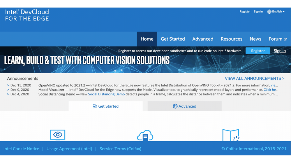

Intel® DevCloud, 1 Click – 0 Cost, way to check performance of Deep Learning models across Intel® hardware
Do you want to know how your model performs across different Intel® Hardware? Intel offers a device sandbox, Intel® DevCloud, where you can develop, test, and run your workloads for free on a cluster of the latest Intel® hardware. Now that you have access to all the latest Intel® hardware all in one place, you must be thinking which Intel® hardware is best for your model? Keeping this in mind, we have brought something so powerful, it will ensure that you know exactly which hardware is best suited for your deep learning model.
In the previous section, you were able to convert your TensorFlow and Keras image classification models and TensorFlow object detection models to OpenVINO IR format and store it in the S3 bucket.
In this section, you’ll be able to take those OpenVINO IR models right from your S3 bucket and benchmark those models on different hardware within Intel® DevCloud in just 1-Click using the provided sample Jupyter notebook.
Jupyter
Ready to try it out on your models? Check out the Benchmark Sample on Intel® DevCloud for the Edge. Just provide your AWS credentials & S3 bucket, and we’ll pull the model from the S3 bucket for you.
