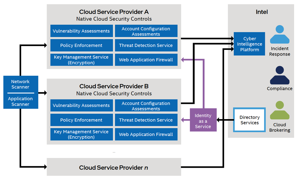

Vendor lock-in may be a concern with using built-in services, but standardizing on a few CSPs and products makes it relatively easy to move between them. Using native cloud security controls does not mean that you cannot use third-party security products or have security processes run on-premises. Intel IT’s architecture for using native cloud security controls, shown in this figure, includes third-party products running on-premises. An additional benefit to standardizing the use of cloud native security services is installation of a minimal level of security. Intel IT has incorporated standardized “guard rails” for applications and services deployed to CSPs so that a baseline of security is automatically built in when Intel’s users deploy to the cloud (blocking potentially hazardous ports is one example). Evaluating and validating both native controls and third-party products is an ongoing process, enabling Intel IT to move in either direction as warranted.
