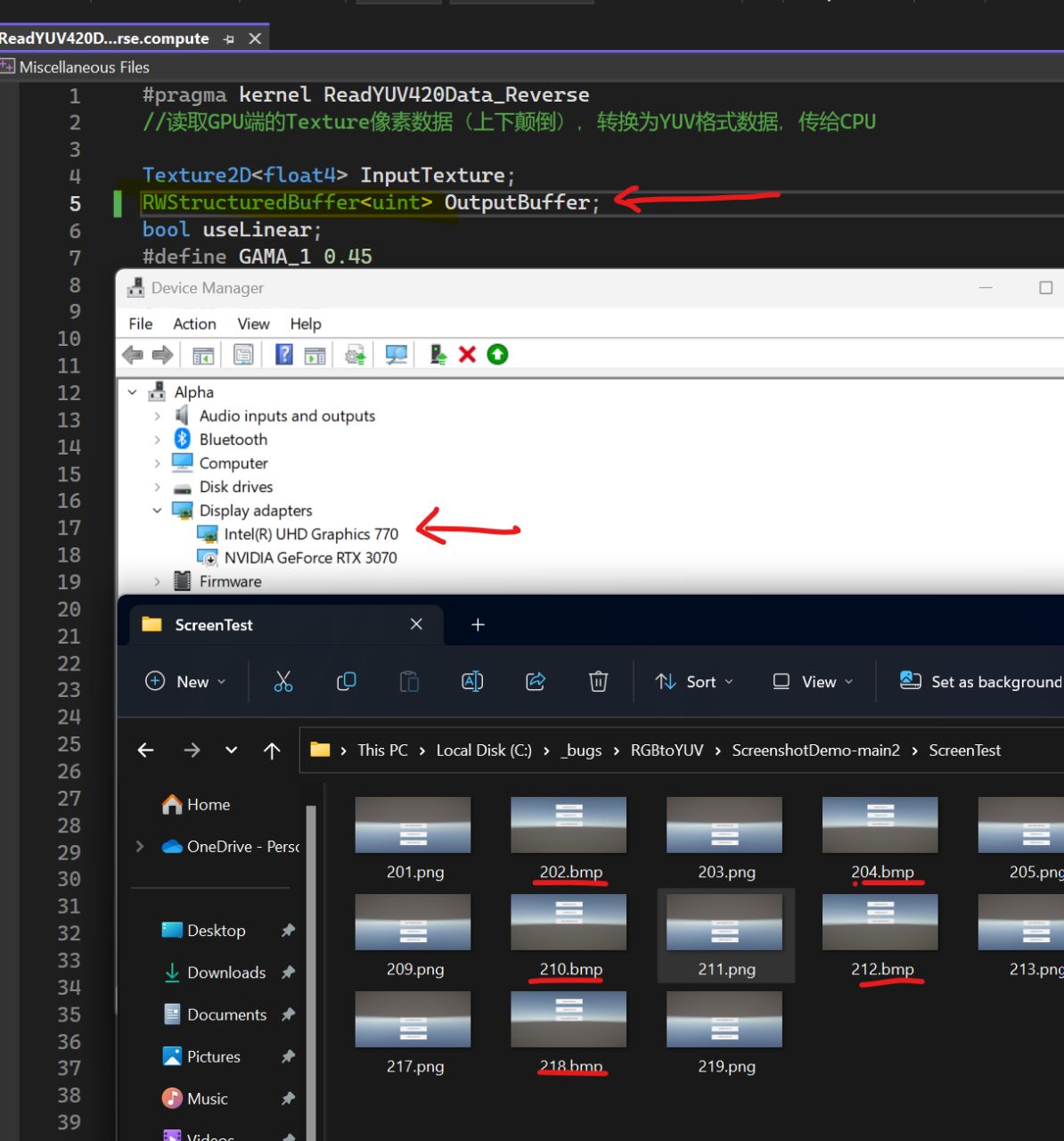

This code can obtain data normally on NVIDIA device, but on Intel UHD Graphics 770 device with ComputeBuffer.GetData failed to obtain valid data. And save tests by ScreenCapture. CaptureScreenshotIntoRenderTexture interface to get to the rt is normal pictures, and rt is 1920 * 1080 pixels.
What causes this and how can I fix it?

I have news, I found the problem and the fix is really simple
You just need to change the type of the OutputBuffer in your shader. from RWbuffer to RWStructuredBuffer.
RWbuffer is basically a 1D texture, the reason for this is in the past (DX10 times)  the HW did not allow any random access to the memory except via the texturing unit, so it was very common to use the 1D texture as a buffer.
I asume, Nvidia API/Drivers change the type of the buffer to a structured one automatically when the call arrives to the HW.
With this change it will work perfectly in both HW.
Please try it and let me know how it goes.

I have already tested it in Unity, but I couldn't find the version you mention (2021.3.4f1c1) it says it is not a valid version.
However I could test with Unity v.2021.3.9f1 and I'm not getting the ComputeBuffer.GetData failed to obtain valid data
In the following screenshot you can see the tests were saved by screen capture in both .bmp and .png
I am using a 13900K desktop machine + ARC 770 + v 4255 Graphics driver
It was also tested using the UHD 770 iGPU with the same graphics driver and I did get output on both scenarios.
Unity SS Output with Intel Gfx v.4255Unity SS Output with Intel Gfx v.4255
Can you try with this Unity + driver combo? Please let me know if this is the expected output or what else can I do to help

hey @OlderW thanks for the clarification on the actual issue.
We were able to reproduce this problem in our lab. I was reviewing the project code you share and debug it all day yesterday. Here are my findings:
The PNG creation is working on both GPUs, meaning that the ScreenCapture data is ok.
I modify a little bit the shader to use the c float definition (X.XXf), but still the problem comes up.
I assume then the problem was in the BMP creation itself, so I create a c++ program to generate from 0 (no 3rd party libs) a BMP image, that worked as intended. No problem in the BMP creation.
The only thing i could not verify/debug properly was the NDLivingModule Package (LiveAdapt.dll) used to convert the uint[] ComputerBuffer object (m_yv420RawData) to the byte[ ] result object. I didnt find any documentation online.
The lib could be using Nvidia API to do the convertions.
I also need to verify if the data obtained from the computer buffer object is the same in both cases.
I am also working on create a convertor from uint to byte from scratch, maybe that would help.

Thank you for the info @OlderW !

@Arturo_Intel According to your modification, solved the problem!
I will learn the difference between RWStructuredBuffer and RWbuffer.
