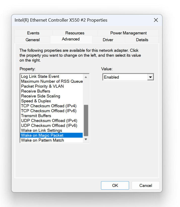

OS: windows11 pro
Network adapters: Intel(R) Ethernet Controller X550
I want to be able to turn on the powered off computer with WOL.
I've set up all the settings, and I've set up the bios.
But it's not working
WOL works well on computers that use different network cards. With the same setup
Does the network card I'm using not support WOL?
Or have I done something wrong?

Hi Poojitha
10-Gigabit Ethernet adapters
Wake-on-LAN isn't supported on Intel® Ethernet 10-gigabit adapters.
I read what you told me
According to the part I copied above, 10g doesn't support WOL, right?
Well, I can't help it. Thank you for your help

I would like to confirm that the Wake-on-LAN feature is not supported on Intel® Ethernet 10-gigabit adapters. We understand that this may impact your requirements, and we apologize for any inconvenience this may have caused.
If you require any further details or assistance with alternative settings, I kindly request you to reach out to your OEM for further analysis and guidance.
