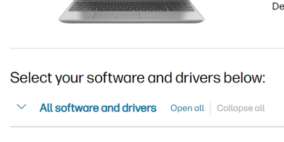

Sorry for not answering before but I was busy all these days trying to solve this problem and I have news
These days I have been trying to make live broadcasts to check if I get the blue screen again but it seems that this problem no longer occurs, that is, I can make transmissions normally, it could have been the formatting that helped solve this, on the other hand the errors in the event viewer are still there
Now answering your question
Yes, I already tried to download the OEM drivers and something that happened was when I installed it that I then had to update it from the HP assistant to the new version (version that I already had before) and also something that is happening in the link that you sent me and that I think does not happen in other HP driver links is that the download options do not appear on my product page, it could be an error on the page or something else, attached image
Does the error message only appears when using OBR and Discord?
Yes, but apparently after formatting, the blue screen no longer appears.
Have you tried performing PC reset?
I have done it many times.
Now looking at the HP assistant, it turns out that my device is not OEM, I've already checked, am I right?
